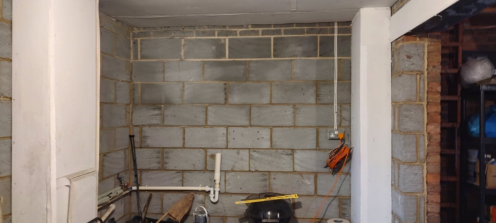

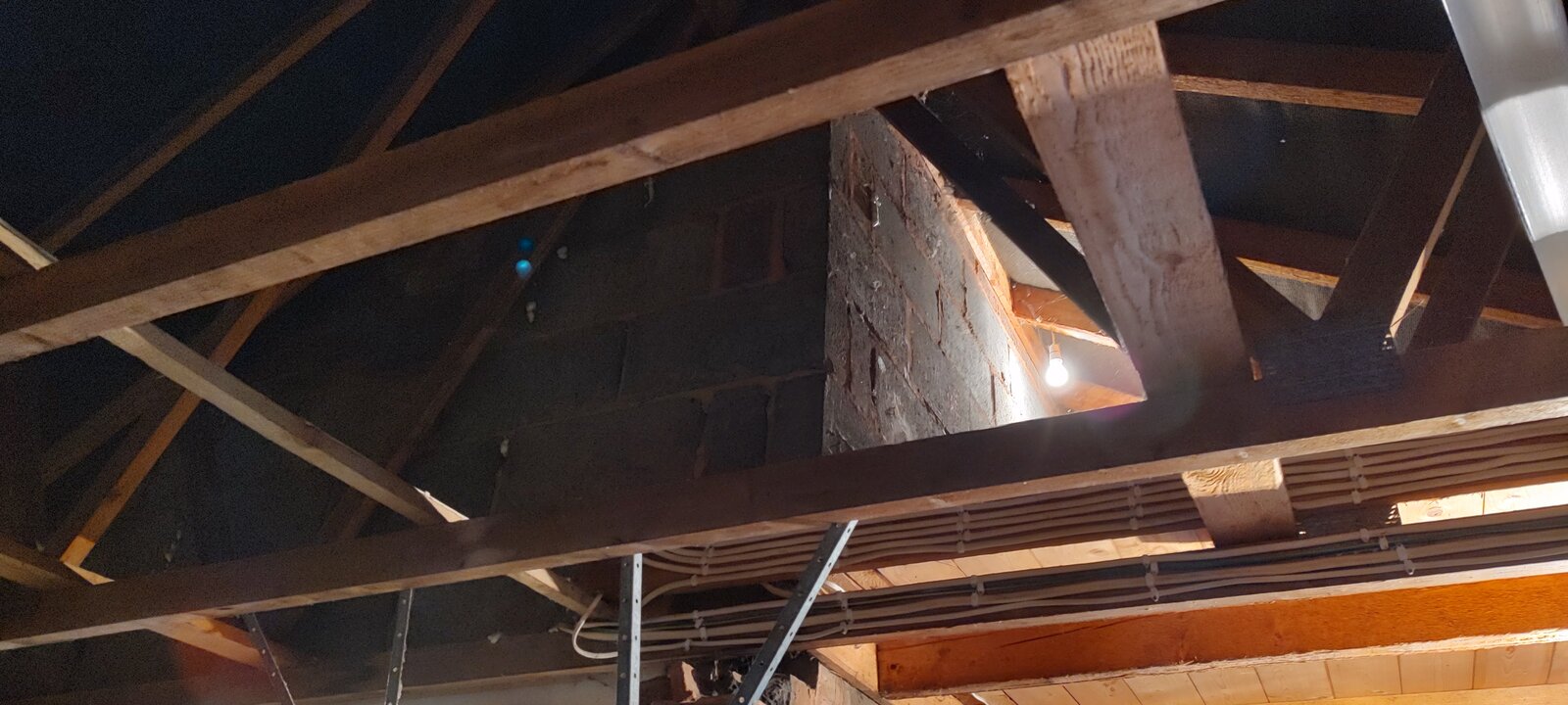

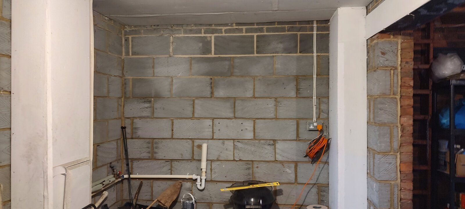

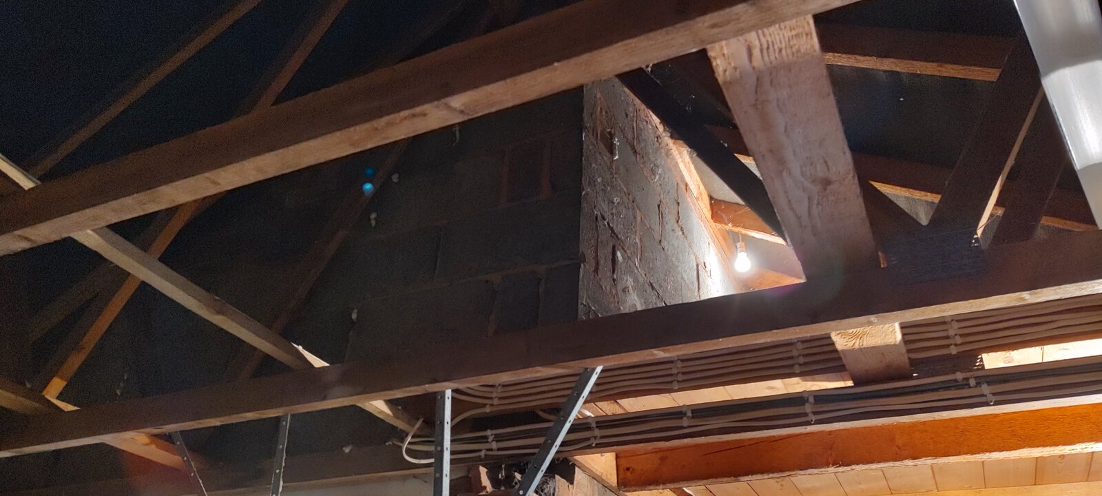

Type of insulation to insulate kitchen & bathroom that back onto garage

If it was mine, I would either dot and dab 50mm insulated plasterboard to the wall, or stud it in 4b2, insulate with 100mm kingspan, and then plasterborad.
