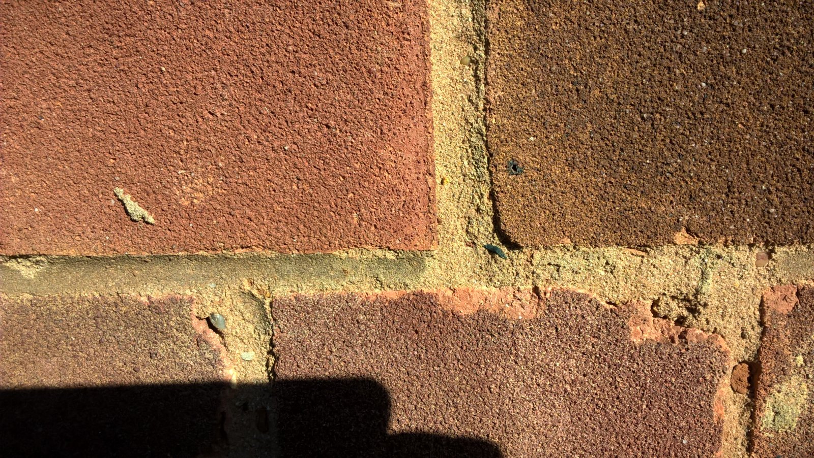

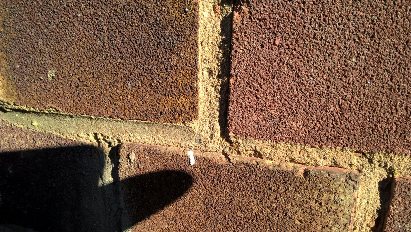

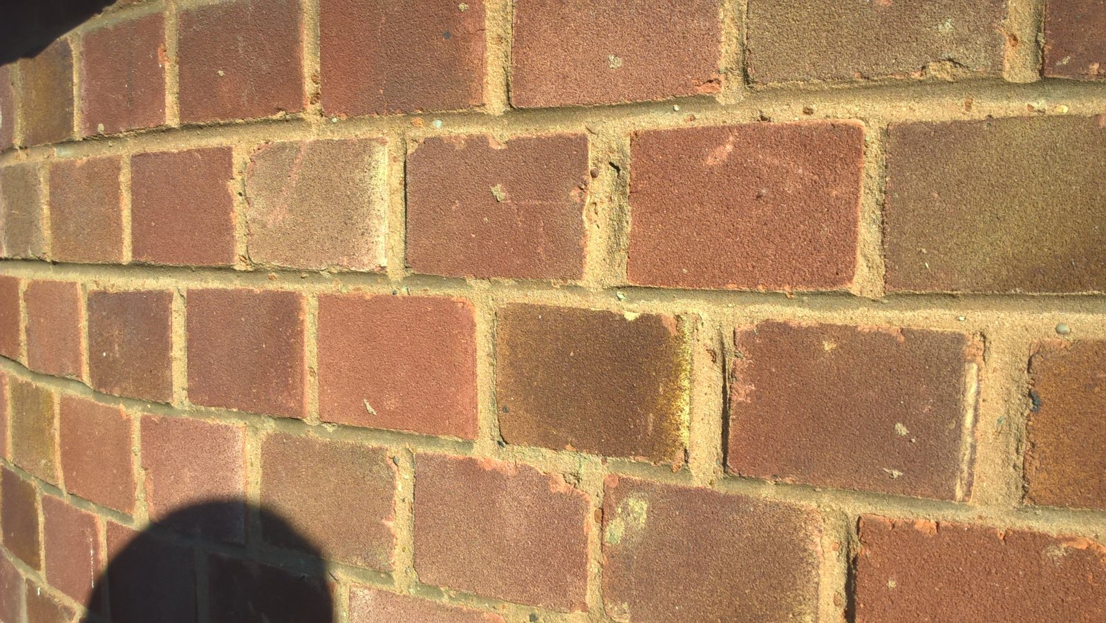

Hi all,
I'm looking at doing some re-pointing to my house but I want to make sure I'm using the correct type of mortar (lime or cement). How can I tell?
I have asked a builder and he assures me it is cement.
The house is a traditional semi built in 1955-1960.
Ok to just use a 4:1 mix of cement and sand?
Thanks' all

The original looks like building sand, which would normally be used on work like this. Building sand does contain a few larger particles which show through when the laitance from the original jointing weathers back. As a rough guide the largest particles should be no more than 1/3 of the joint size.
The workability of sharp sand can be improved by mixing for a good 30 minutes, or about 20 with lime mortar, but in this case I myself would be using a building sand.
