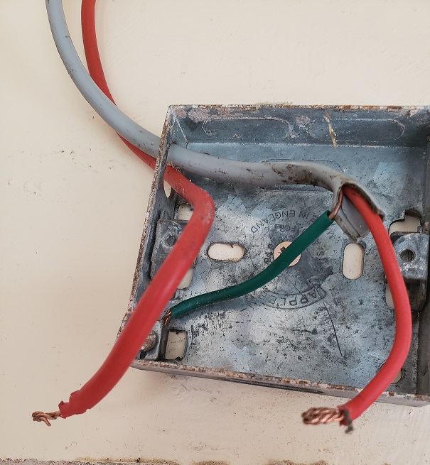

Hi,
I've been swapping some light switches and light fittings recently and being an older house, late 70's I think.
I found the lighting circuit runs off this wire, this being the live to all the switches, with an accompanying sheathed (red or black depending if its from the switch to light or the light to another light) and earth running along inside it.
The sockets run off twin and earth. So i'm wondering if this was the normal setup back in the day and what would you call this type of wiring with the live being separate.
Seems weird to me not to just use twin and earth for the lot unless 1.5mm didn't exist.
It's just single insulated and sheathed (plus earth) for when only one wire is required from point to point - switch to switch and/or switch to light as you have realised.
Nothing normal nor odd.

1.5mm would be oversized if it did exist. 1.0mm is the size for lighting. What you have is probably 3/029 imperial cable.
I did think about that and decided that “he thinks” late 70’s was mistaken. The cable certainly looks like imperial to me.
It does, not the least because it is certainly stranded. However, I may be wrong but IU had a feeling that there was a brief period during which stranded metric T+E was available?
... and I suppose I should have added that 3/029" was closer to 1.5mm² than to 1.0mm² - so I wonder what you thought about the use of that for lighting circuits?

Never come across stranded metric cable in those sizes.
3/029 works out at 1.28mm2 so midway between the two sizes. 1/044 [=0.98mm2] was also used for lighting but as far as I know singles not T&E.
1/.044 was definitely available in twin rubber sheathed (no earth!!!!!). My parents 1938-built house had it on the lighting circuit, but the 2-pin sockets (also on the lighting circuit) were wired in 3/.029

3.029 singles, plus 3.029 single with earth. 1970's -ish. The Appleby back box is a type intended to be a sunk in the wall type, not intenged for a surface mounting.
