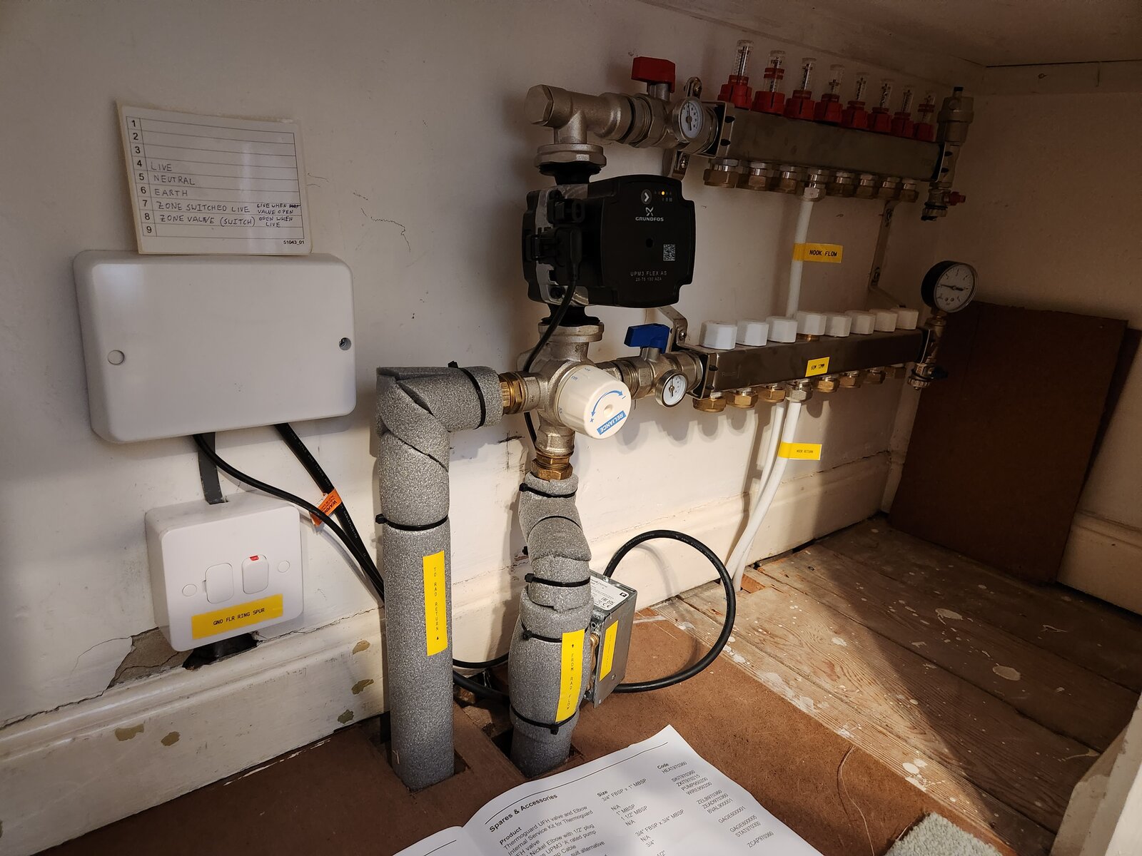

I have installed a UFH manifold with one 60m 12mm loop and the flow to the UFH loop is too hot.
The flow into the manifold is 36C and the return is 32C. I'm planning to put an engineered wood floor on top of the ufh so my maximum flow temp must be 27C or I'll risk damaging the floor.

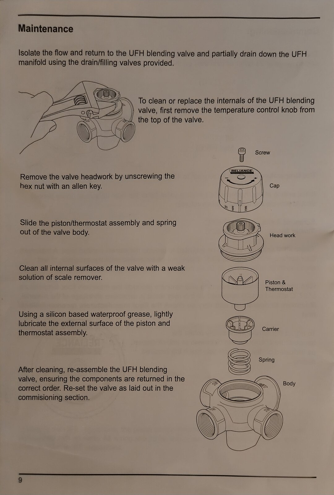

Im using the Reliance 3/4"-1" UFH Thermoguard Blending valve in front of the manifold and it's set to minimum, which should be 26C. The flow into the manifold is from the radiator circuit and its plumbed in with a 22mm flow and return. The boiler is set to 65C (since the water tank needs to reach that temp).
Why is my blending valve not working as intended?
