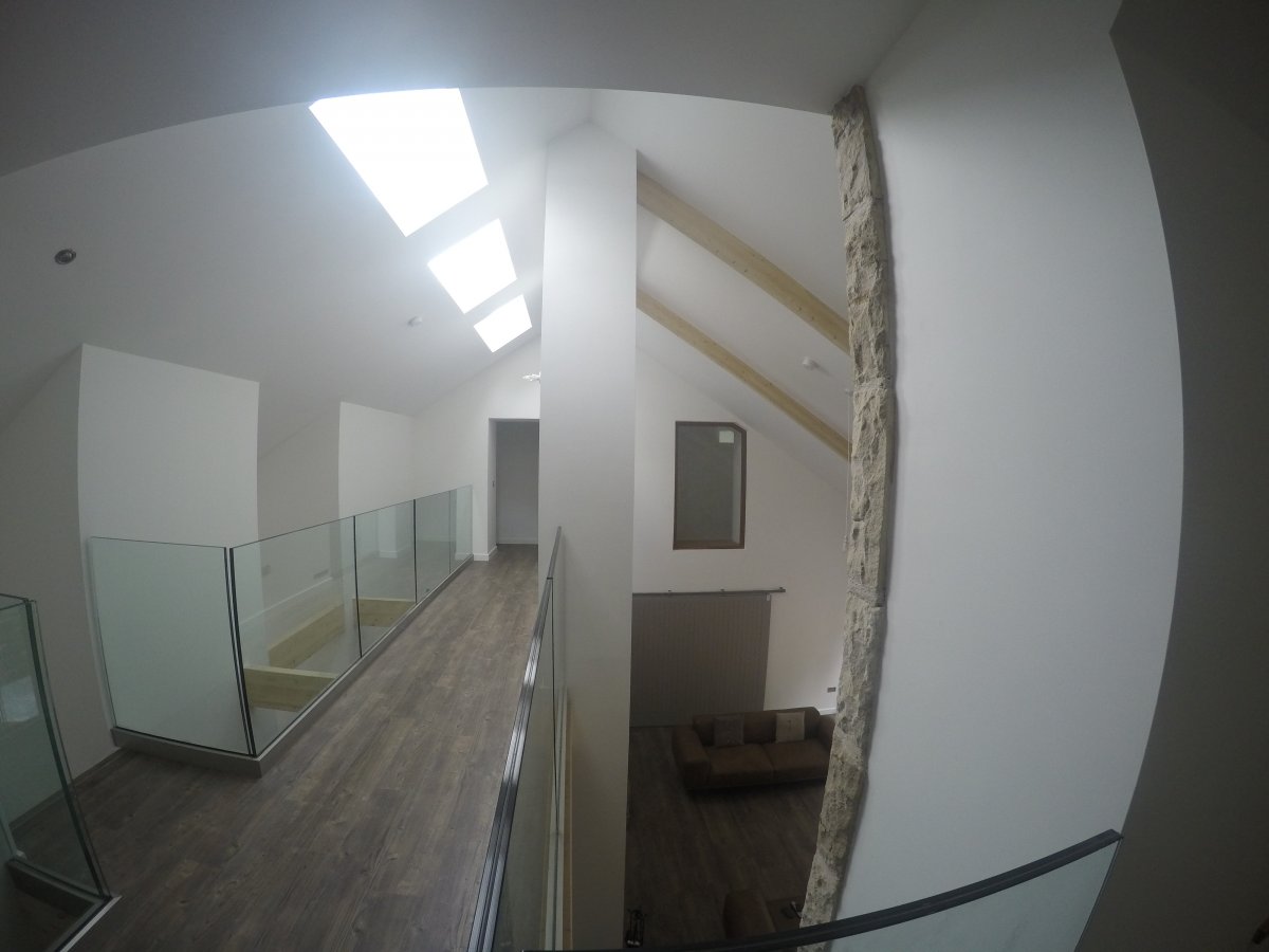

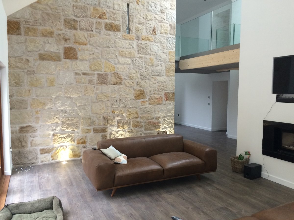

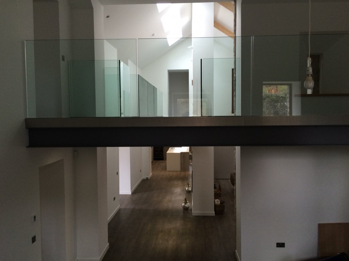

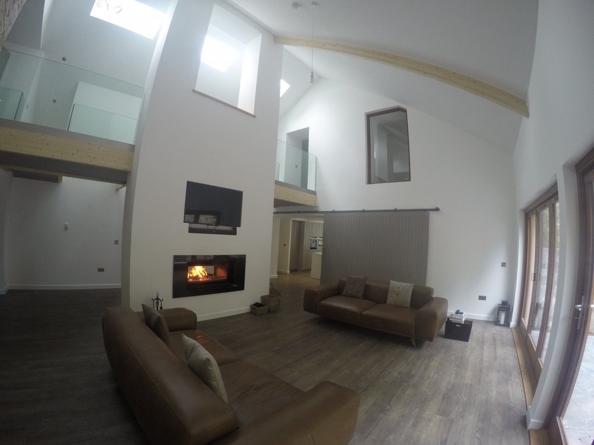

Brother has it in his 450 year old farmhouse with wattle and daub walls. With rads on the upstairs. Wonder how he copes.... Let me just check on his home automation app.
So bennyboy tell me how rads will heat my lounge evenly?
2.5 storey height and over several rooms?
Go on tell me?
Isn't going to happen is it really. Much like our ground floor - 70 square metre open planned living area in a U shape and a long bare wall. Rads would look crap and leave massive cold spots.
