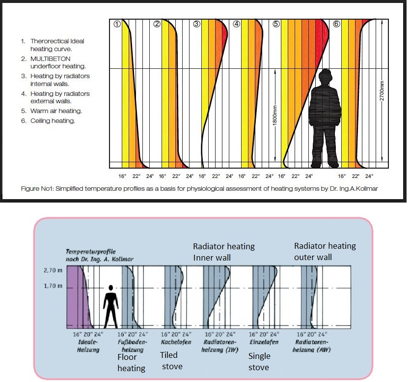

With vertical open plan would the set back be for the upper floors or the lower floors ? How does UFH deal with steep vertical temprature gradients ? ( for new readers warm air rises ) .
How do you think radiators in a vertical open plan is going react? Do you understand the difference between convection and radiation?
Do you understand how that affects perceived comfort?
It might be that Dr Ing Albrecht Kollmar's ideas have been surpassed by now, it was way back in 1954 that he contributed to this book

I recall ( but maybe wrong ) that he contributed to the Philip's Experimental House project
He also has patents for warm air heating equipment dated in the 1950's.
