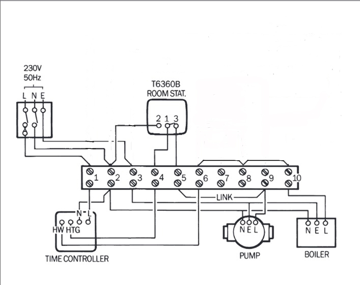

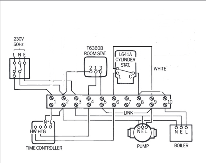

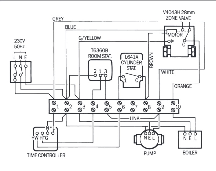

The C-Plan over the years was modified. C-Plan_old2.jpgC-Plan_old.jpgC-Plan.jpg The original no control over DHW, if central heating on, it would heat DHW, the second allowed one to use boiler in the summer, to heat DHW, and the final allowed one to control DHW summer and winter. There were special programmers, with switches and sliders for other Plans they were called 16 programs, and for C-Plan 10 programs, they counted off as a program, a bit of a cheat really.
