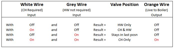

When unpowered, the motorised valve is held by a spring to close the central heating outlet.
When central heating is required, the motorised valve receives power (on its white wire) from the room thermostat via the programmer to operate the motorised valve motor and open the heating outlet.
If the thermostat, or programmer go 'off', the live should be lost and the spring pulls the valve back to close off the heating port.
It's possible, if it's been wired in wrongly that there is still a live on the white wire when there shouldn't be. Someone with electrical knowledge and a multimeter would be able to physically check this.

To help the OP, though, can we agree though that there is a problem with the valve when the white is live (heating required) the grey is live (hot water not required) but the orange isn't live? It should be live as per your diagram below:

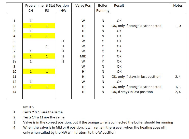

Results of more tests with orange wire disconnect
These tests were done in sequence
Cylinder stat always on
P is programmer,
rs is room stat
v is 3 port vale indicator position
b is boiler firing ( yes/ no)
P reset is programmer switched off and then on
P reset
1 CH on, W off, rs off, v W, b no
2 CH on, W off, rs on, v H, b no
3 CH on, W off, rs off, v H, b no
4 CH on W off, rs on, v H, b noh
P reset, rs off, v back to W, b no
5 CH off, W on, rs off, v W, b yes
6 CH off, W on, rs on, v W, b yes
7 CH on, W on, rs off, v W, b yes
8 CH on, W on, rs on, v Mid, b yes
8a CH on, W on, rs off, v W, b yes
P reset, rs off, v W, b no
9 CH off, W off, rs off, v W, b no
10 CH on, W off, rs on, v H, b no
11 CH off, W off, rs off, v H, b no
P Reset rs off valve back to W
12 CH on, W off, rs off, v W, b no
13 CH on, W off, rs on, v H, b no
14 CH off, W off, rs off, v H, b no
P reset returns v to W position
This clearly shows the valve with orange not connected cannot return from position H to W after boiler fires unless power is turned off. When heating and hot water are both on valve is in mid position. When room stat turns off and there is still a cylinder stat demand for heat the valve returns to W position.
With all wires connected and both heating and hot water on, the room stat operates properly and the central heating goes on and off dependant on room temperature as normal. This only occurs when hot water is heating up. When cylinder stat is satisfied the central heating gets stuck on because the 3 port valve does not return to W position when room stat temp is reached. This means that it all works OK until hot water demand from cylinder stat switches off. Thereafter its stuck on central heating on until programmer is switched off from mains power.
I thank everyone for the advice so far and apologise for not making what is happening clear but it has just become clear to me following carry out all the tests you suggested Stem. They were very helpful to my understanding, a special thank you for that.
Question is.... Why is this happening? Please advise me.

The result of your tests are all what I would expect; there is nothing unusual about them. The fact that the valve does not return from H to W when the demand for CH ends has nothing to do with the orange wire being disconnected. It is a "feature" of the mid-position valve. The valve stays in H position until either the power is turned off then on, or until there is a call for heat from the HW side.
The 115V you measured on the orange wire when in the "stuck" position is about right (Honeywell say 50V to 150V). I have attached Honeywell's FAQ on the Mid-Position Valve.
The problem is not caused by your valve but by the boiler. For some unknown reason it is lighting when there is only 115V on the switched live. Glow-worm will have the solution. Their Home-owner Technical Support no is: 0344 736 0059. If you had the new components installed by a Gas Safe registered engineer, you should get him to deal with the problem.

However, during bench testing of the motorised valve, it revealed that a live on the white wire and grey wire didn't result in a corresponding live on the orange wire, which there should be.
stem said:
The absence of the 230V on the orange wire when the valve is in H position (white and grey live) should mean that the boiler wouldn't come on when the valve was in the H position, when in reality the opposite is true....which is really baffling... Anyway, if the 230V is missing, under these circumstances, the valve is still not working correctly.

Don't be too concerned about this, it's quite normal, when the heating goes off, if the water is also off, the valve remains in its current position until called for by the hot water. Turning off the power simply replicates a call for HW.
I have tabulated your tests with notes so it's easier for me to follow. Yellow shows when both the programmer and room stat are calling for heat. You don't show what the cylinder thermostat is doing, so I've assumed it's calling for heat as the results suggest. The results are pretty normal, however the problem still seems to be, what we discussed earlier:

With the orange wire disconnected and only the heating 'on' the valve should move to H as it has, but the boiler should not be firing (because it's the orange wire that does that) This will need investigation to find out where the boiler is still being energised from.
Something is telling the boiler to fire when it shouldn't be, it may be the spurious 115V as D Hailsham suggests. I would be interested to know where it is coming from. The heating controls shouldn't be generating it and the results seem to suggest they aren't, So, if the boiler is generating it internally I don't see why it the boiler keep running after the hot water has been operating. Anyway as controls are my thing and I'm not an expert on boiler internals, I leave that bit to the gas safe guys.
I originally asked you disconnect the orange wire only to carry out a specific test, from your post above it seems to be still disconnected.
As long as the boiler pcb is correct and the external wiring is correct,Some boilers will fire up with with much lower voltage applied to the switch live. Installing a 0.47 microfarad capacitor fitted between the SL & N on the boiler wiring connection block has been the answer for many worcesters & other gw boilers.
If that is correct, how is the boiler lighting when CH only is called?

As to the source of the spurious 115V, read the Honeywell FAQ.
Note 4 is not correct; the valve does not remain in mid-position when CH goes off. When the valve is in mid-position, both CH and HW must be calling for heat. If CH stops calling, there is no voltage on the white wire, so the valve is no longer held in mid-position by R1 and the diode. The vlave therfore returns to the HW position. If HW stops calling, the grey wire becomes live, via programmer or HW stat, so the valve moves to the CH position. It's only when the valve is in CH position and the call for heat stops that the valve remains in the CH position and 115v appears on the orange wire.

To clarify D Hailsham question re: testing of motorised valve.
Results from the OP. Bench test with the valve wired to two switches that provide lives to white and grey wires, and with multimeter on orange wire. Result when both white and grey wires are live, no output on Orange wire.
I have made a two switch test rig
White on grey on valve is in H position slight voltage 0.1v on orange wire
Test results of valve when wired into the heating system, shows 115V has appeared.
Orange wire 3 port valve at H with CH programmer demand 115v
Hope this helps.
I read about the two switches and the strange result it gave when "bench tested", which contradicts the result when "wired into the heating system", and thought - that's not right. Then I thought - How exactly is he carrying out the bench test? Is the valve still plumbed in? Or has it been removed completely? Or has just the actuator been removed? Only the OP can answer that question, so please don't speculate.
