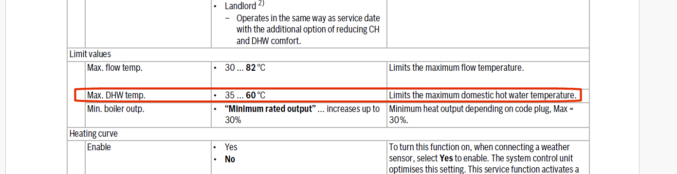

I had a Worcester Bosch Greenstar 4000 installed in November 2024.
I wanted to increase the hot water temperature above 60 so I can fill my bath more quickly with hot water for my occasional soak in the bath.
On the boiler display the maximum hot water temperature is 60 yet on the Comfort + 2 RF control unit the hot water maximum can be set up to 70 degrees.
How do I increase the hot water temperature on the boiler above 60. I don't use the control unit for hot water as I use the Eco mode.
Any suggestions would be appreciated. I am new to the world of combination boilers and still learning. Thank you.

Your 24kW? combi will give a flowrate, at 60C, of, 24*860/60/(60-10), 6.88LPM, from a (my) present mains temp of 10C, if you require a bath temperature of say 50C, then you mix the mains cold water at a rate of 1.72LPM with the 6.88LPM at 60C to give a flowrate of 8.6LPM at 50C.
If you set the combi HW temp to 50C then a 24kW combi will give a flowrate of, 24*860/60/(50-10), 8.6LPM, no different to the above, bath will take same time to fill.

You 4000 combi is factory set where it has @ a max of 60Deg
The DHW function on the controller will do nothing on a combi, it is more for a system/reg boiler with the additional controls kit that would manage a DHW cylinder with diverter valve and cylinder stat.

As johntheo5 said, even if you could increase the temperature (which you can't) the bath wouldn't fill any faster. It's a bit like the old joke "must write faster because my pen's running out".

Your 30 combi will give a flowrate, at 60C, of, 30*860/60/(60-10), 8.6LPM, from a (my) present mains temp of 10C, if you require a bath temperature of say 50C, then you mix the mains cold water at a rate of 2.15LPM with the 8.6LPM at 60C to give a flowrate of 10.75LPM at 50C.
If you set the combi HW temp to 50C then a 30kW combi will give a flowrate of, 30*860/60/(50-10),10.75 LPM, no different to the above, bath will take same time to fill.
It would take huge power to give the same flowrate from a combi as from a HW cylinder, a 200L HW cylinder can be heated to 60C (from 10C) overnight in less than 4 hrs with only a 3kW heating coil or immersion element and can fill your bath at say 18LPM or greater to fill it rapidly but to get this (instant) waterflow rate of 18LPM at 60C from a combi would require a power rating of almost 63kW.
