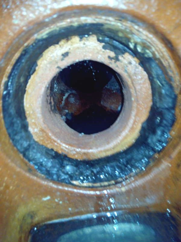

Here are a couple of pictures of the chamber:
I would imagine that the plug has been in place since the house was built in 1964 and if that's the case then I don't know how it has worked up until now.
The black stuff around the hole is what was holding the plug in place and I just cannot figure out how the waste has got past the plug and into the drain.

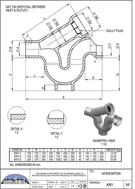

It simply went via the trap below - which fats' diagram shows. The idea of the trap is to stop smells coming up. It discourages rats too, though they can swim through.
All sewer "manholes" used to have much the same arrangement but practice changed so the plugs are left out.
The trap fills with gunk (hard) and everything goes down what used to be blocked by the plug, above.
If you get smells you might need to refurbish it. That would mean cleaning the trap properly and replacing the plug/seal, which has obviously disintegrated. No idea what seal would have been used in '64. It was probably hemp and tallow or something similar at one time :)

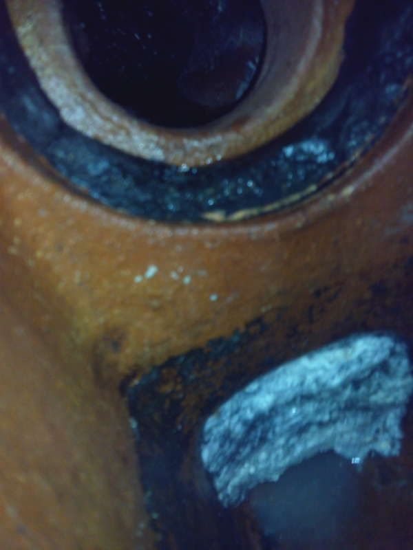

Ah, it's starting to make sense now. I didn't realise there was another exit hole further down in the chamber. I've now sucked all the water out with a wet/dry vacuum and this is what I've got:
As you can see the bottom is still blocked up but it is quite soft. So I shall have a go at clearing it.
Any suggestions for clearing it. I've been using soda crystals and hot water which has got me this far (you should have seen it before I started). Due to the confined space I can't get in there very well but I'll have a hunt around for something flexible.

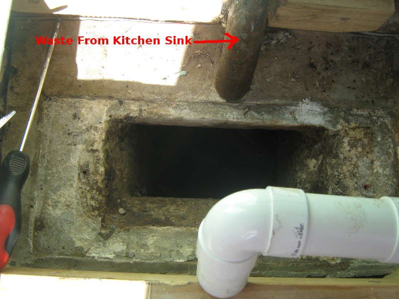

Here are some pictures showing the waste pipes.
This one shows the waste pipe from the kitchen going through the concrete and into the gulley

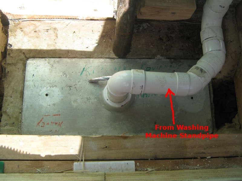

...and this one shows the aluminium plate that is normally sealed with a bead of silicone and screwed down. The washing machine waste fits through a push fit connector fitted into the plate.
This is then all covered with a trap door in the conservatory floor.
I realise that the plug will need to be refitted to prevent fumes coming up from the drain. I was going to ask what would be the best thing to seal it in place with. Would silicone not make it a bit difficult to remove in the future especially with the limited access.
I have now cleared the waste exit hole at the bottom of the chamber by leaving some 'Mister Muscle Sink & Drain Unblocker' sitting in the bottom of the chamber over night and then washing it through with about five sink fulls of hot water. It now appears to be running through very quickly with no backing up whatsoever no matter how quickly I pour water down the drain.
So I think everything is clear now and I just need to refit the plug into the rodding eye.
