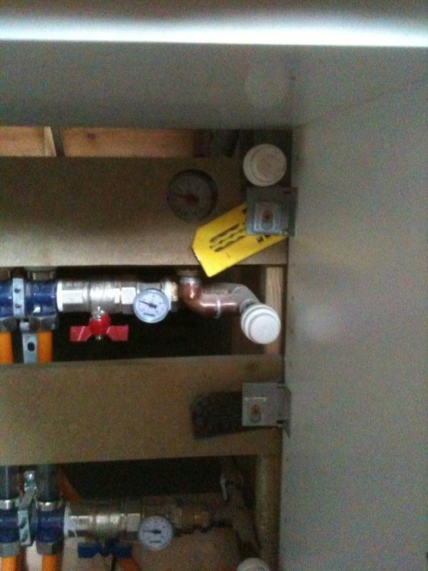

I have an underfloor heating setup that is missing some bits, could someone kindly let me know whats missing?
There are 3 white bungs on the right of the pictures, am I missing a blending valve or something? (easy to fit or should I get a pro in)
The top bung is the hot water from the boiler, and the middle bung is connected to the manfold and the hot feed, take it the bottom would be return or something?
Basically you should have your flow from the boiler going to a pump which is connected to a belnding valve which feeds the manifolds flow and return and then return to boiler.
If you google a pumpset you will see what is missing.
You may also need a 2 port valve and a limit stat too depending on what has or has not been installed.
Goodluck

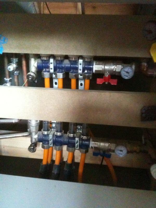

Also just so I understand.. is this a 4 zone system?
Can you let me know the basics of how this works, ie i know the top rail is hot and the bottom cold, but the orange pipes are coming out of the top and bottom, how does all that work?
Looking at the images I would say this is missing....
A circulator is also missing.
Could obviously be there though and obscured in your images.

Not sure if there is a circulator, its just basic pipework a few glass bottles showing water level I presume and a few gauges, other than that there is not much there at the back of the installation.

You have a 4 port manifold which means you have 4 loops with a flow from the manifold with the clear vials which show flow rates in ltrs and the return via the second manifold.
The hot water from the boiler is usually too hot for underfloor heating so it is blended/mixed with the cooler return manifold to give a set temp to the flow manifold.
The seperate pump circulates this water around the loops independently to the rest of the heating network.
You will need to fill these loops via the end of the manifold which accepts a hose pipe bsp connection to 1 bar cold. You cannot use the filling loop on the main circuit to do this as it will not work.
