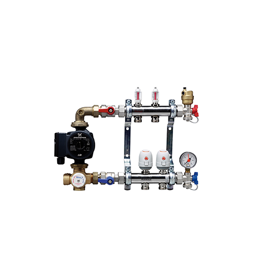

Hello I wonder if anyone can give me a pointer on whats happening re the above.I have underfloor heating in a conservatory which runs from the house Central Heating system.I have located where the system is plumbed into the main house plumbing and there is a Gundfos pump which I presume activates when the Thermostat demands .I have never used the Underfloor heating since moving into this property but noticed after having a Worcestor Combi boiler fitted that the Ufloor heating works slightly...I guess its somehow pushing the hot water through the Ufloor pump.So heres the question ...does this seem about right ? and would it be possible to stop it, or even is it worth bothering to stop it ?.Hopefully someone has done this before and can help me,thanks in advance.

Andy, there is usually a manifold near/in the conservatory, something that looks like: UFH.png With a room thermostat for the conservatory only. In all honesty an image of your set up would be helpful.
Morning Mike,I am in the process of decorating/altering the room adjacent to the conservatory and yes indeed under the floor in there is the pump/blender
and associated wiring which goes as you say to the conserve. thermostat.I just wanted to try and find a simple effective solution to the problem if there is one (beginning to doubt that).When the carpet is laid all the pump etc is obviously a bit inaccessible ,not the best idea the prev. plumber had.
