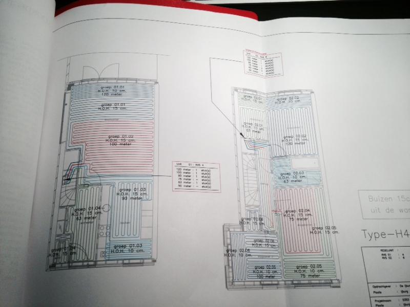

Now, the problem we have is that we put carpets and underlay upstairs and laminate downstairs - we followed all guidelines re: carpet etc... but, with only 1 thermo stat, it is causing a large temp difference. approx. 2.5 during day and 5 degs by the time morning comes around again. We are cold at night :(

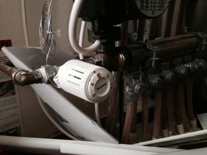

On each manifold (after consulting with the company that installed the systems) - there are 2 thermostatic valves.... one controls the supply and one controls the return (water back out the property to the power station).

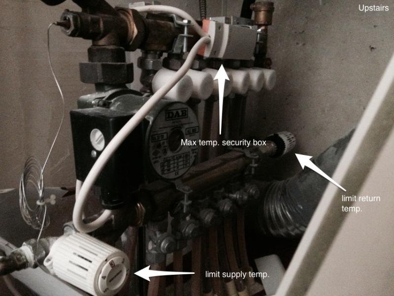

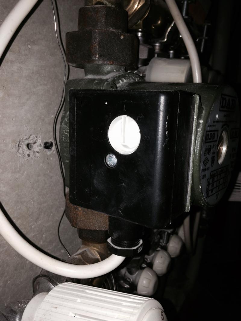

Also on each manifold is a small box which has an electrical supply and is attached to the pump on each manifold - according to the company that installed it, this is a device that cuts of electricity to the pump if the temp. gets above 60degs C - to protect the system / floor from over heating.
The problem I have, is that apparently the power company that controls the water to the properties, has regulations that do not permit the supply valve to go as high as 5 (it has dial 1-5) - I believe it is only 1-4 that is permitted. In our case, each valve is locked and will not allow us to get above 3.

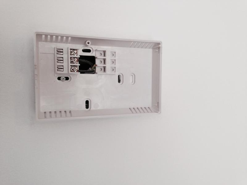

I took the thermostat off the wall (as it detaches, in order to change batteries - you can see pic) and took upstairs with me, and it monitors the upstairs temperature as expected - as the sensor is on this unit - and, it appears to control the heating as it does when downstairs....
So, my questions(s) are:
1. Can anyone see from the pictures how the actual communication between the thermostat and heating system is taking place?

3. Does anyone know anything about this temp limiting device? There seems to be a small selector on each unit, with options 1,2,3 - downstairs is at 1, upstairs is at 2.

Try increasing the valve setting on the left.
Are you sure the valve on the right is a return temperature limiter?
Try adjusting that valve to increase the return temperature.
Which should automatically increase the flow rate.
The return temperature limiter will slow down the response time on your floor heating.
Some systems with modulating valves can boost the flow temperature to increase the response time on heat up. And work very well.
If a return temperature limiter was fitted it would make that function virtually useless.

The thermostatic valves with numbers 1-5 represent the temperetures 1 23° C,
2 34° C,
3 45° C,
4 56° C,
5 67° C.
Normally the position is between 3 and 4.
The Nest control system is a low voltage system, all systems at Blok 17 are 230 V.
So you cannot use a Nest control system.

Valve nr. 1 is the supply and volve 2 is to limit the return temperature.
Both valves are locked, due to regulations of “NUON Stadsverwarming”. (nr. 2 must be locked at 4 anyway)
The white/yellow box is a maximum temperature security box. It breaks the electric circuit of the circulationpump at > 60 degr. C. to protect your underfloor.

"Both valves are locked, due to regulations"
I'd be unlocking the return temperature limiter.
Also there's a special way to lay UFH pipes when a valve with that capability is fitted.

"Does this mean that it keeps the water in my system until the temperature drops to a low enough level, to be "sent back" the the supplier? "
Yes.
It's a flow restrictor based on temperature.

Yes wrong pipe layouts.
When you control the return temp then double meander as used by Rehau are essential.
As it balances the floor temperature much more evenly.

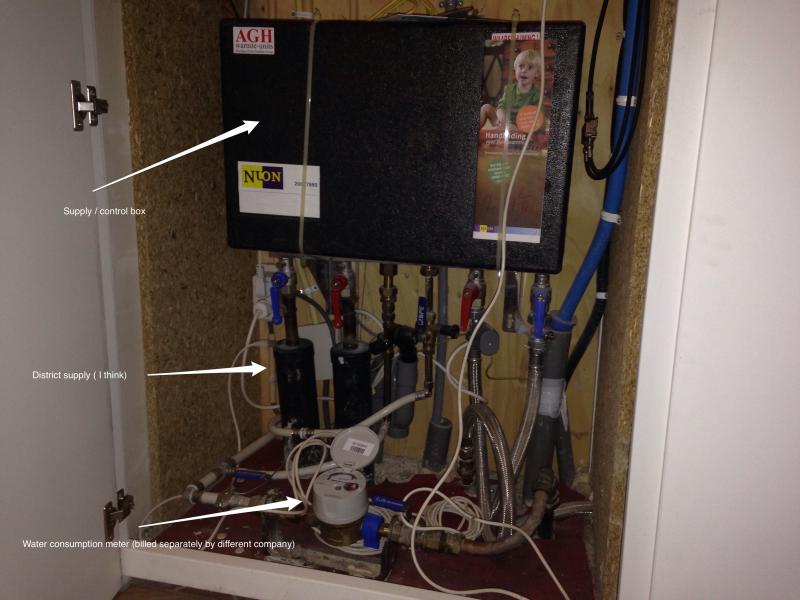

It might have something to do with how you are being billed.
Hmm, they install a big box which is sealed with huge cable ties - so i've never seen inside it, but it's a kind of polystrene effort (see pic).
There is then a meter coming out of this - it was my understanding that the billing is done as the water enters the property.....
I'm not sure I understand about the pipe layouts - so they should be laid a different way? It wouldn't surprise me if they did it the wrong, easiest way - most things in Holland seem to be the easiest way and not necessarily the best way.....

I managed to get the caps off the thermos valve (actually, it looks like it has been done before...) and was able to turn it up - but, this didn't really have any affect. Infact, I'm beginning to think of something else is faulty.
The pump appears to be operating - but, I'm basing that on the fact that I can hear it / feel it - however, the whole system now (upstairs) - even although the heating is on, is stone cold - downstairs is not - it is really warm to the touch (manifold etc).
Even the supply pipe, which comes from downstairs, up to the thermos valve is cold..... does this point maybe to the yellow/white box which is supposed to be regulating temp?
