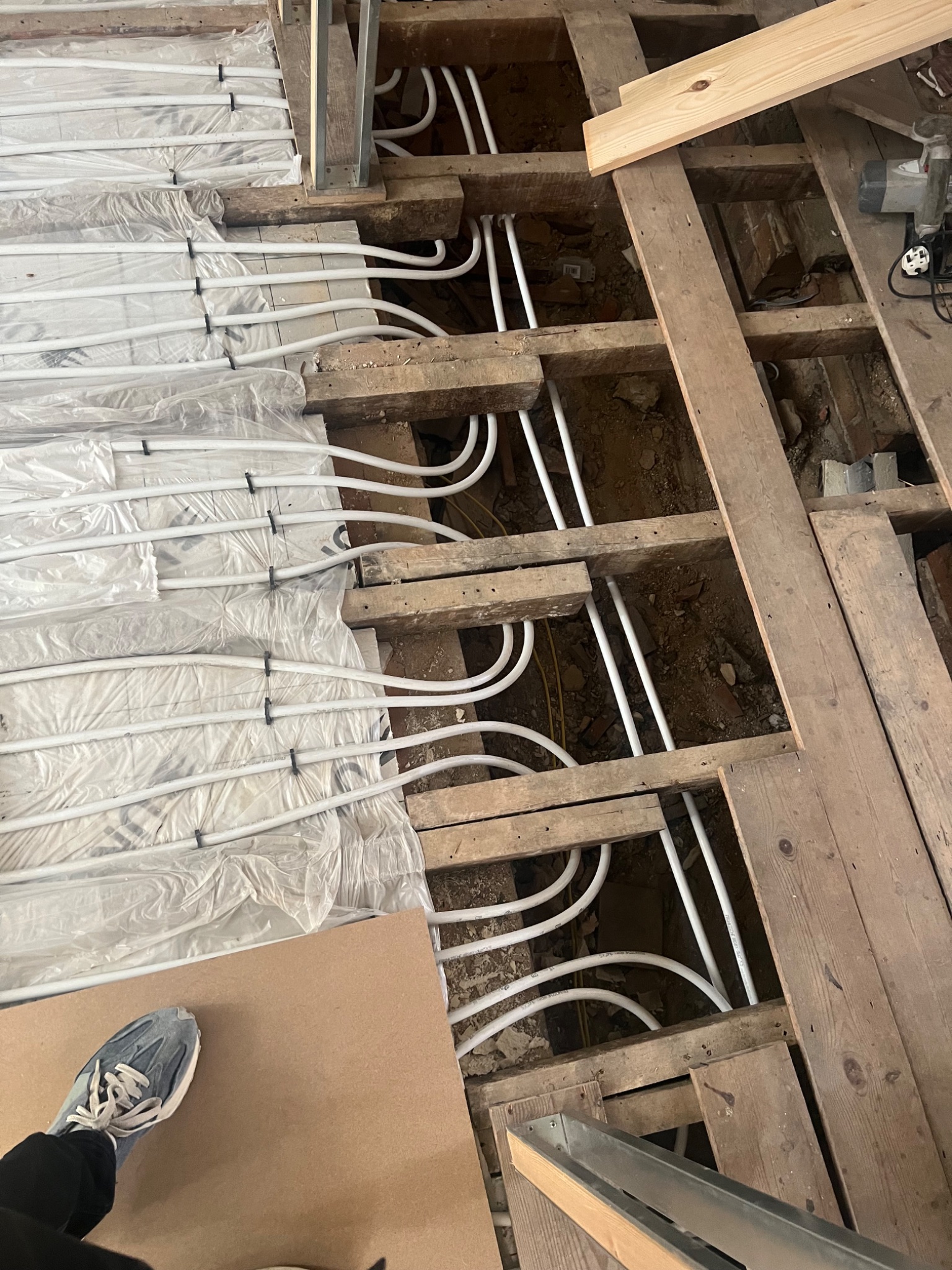

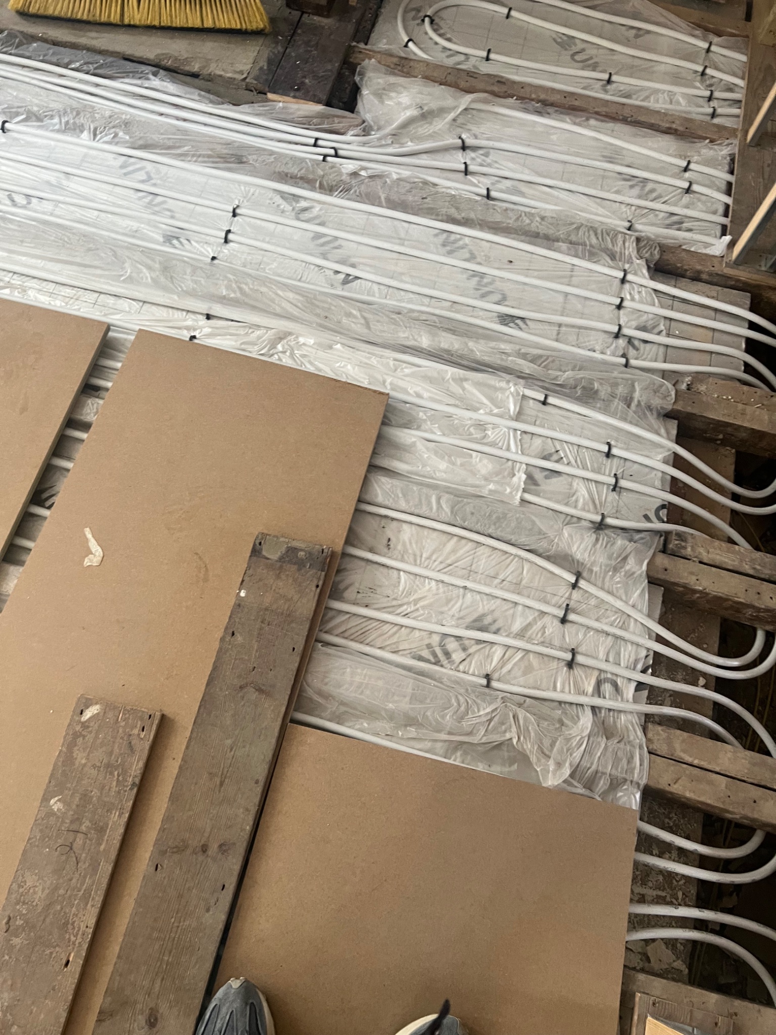

Got a Plummer to install some underfloor heating pipe . I need feed back on this picture if he is doing it right.

Retrofit is never easy, but doesn't look too bad.
Insulate anything in open voids.
What is the void being filled with, on top of the KS, to create the thermal mass? Is it to be a biscuit mix? I'd also be looking to insulate the loops under the joists. I guess if to be picky then the loops could have gone through the joists and the insulation extended.
