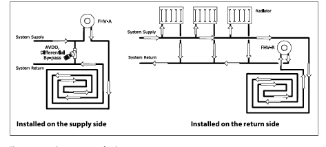

Depends on the size of the loop and how you want to control the rooms UFH.
small setup would look like this using the FHV on flow or return, valve dependent
If you want direct zone control of just the living room UFH and temp, then that would need it's own zone valve and stat. If you'd be happy that the UFH goes off when the normal room stat turns off the rest of the heating, then not necessarily needed. As far as a pump is concerned then If the length of the pipe loop gets over a certain size, then the boiler pump may not be able to cope with the demand of the UFH and satisfy the rest of the system at the same time so an extra pump may be needed.
That would normally all come in a single setup with a a manifold with mixing valve, pump, flow meters and actuators controlled by thermostats.
