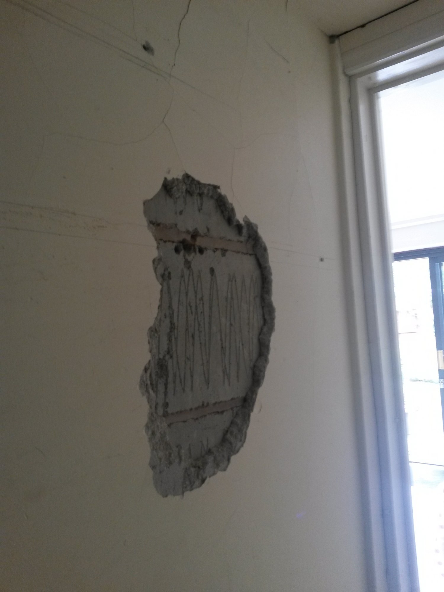

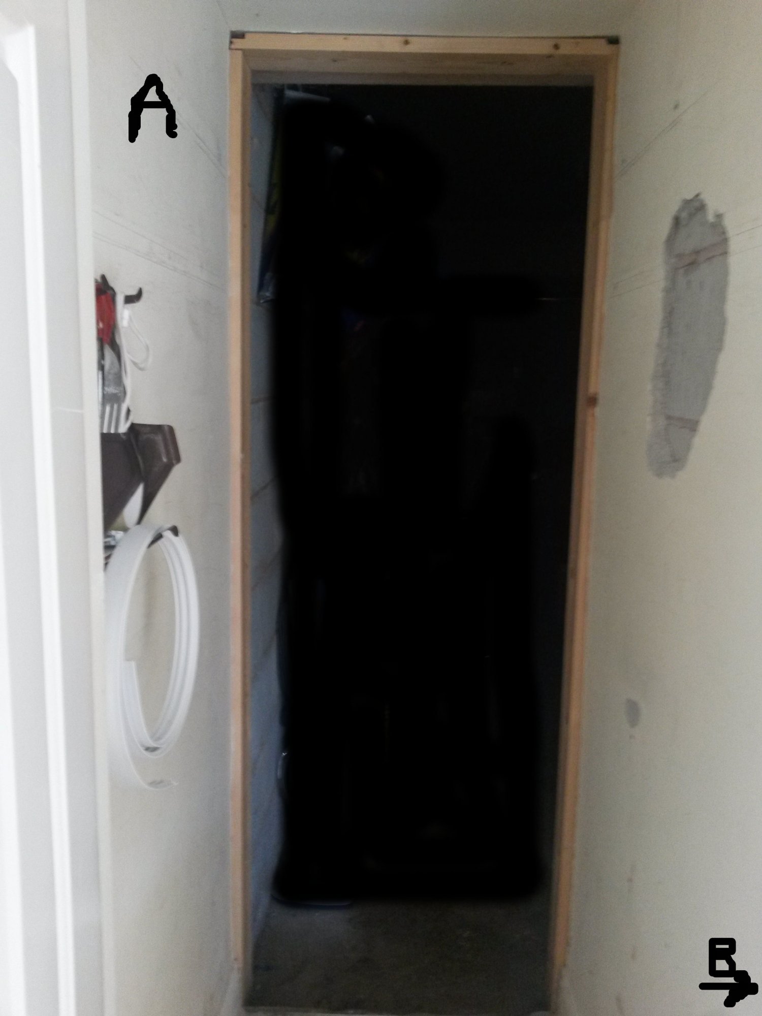

I want to create some extra space under our stairs. is it doable? do I need supports? I dont think its a support wall. its in a small walkway (700mm width) to garage. (A) is an external wall, (B) is a load internal wall between inside room and garage, the other side (C) inside garage aerated block, same as this wall i want down.

Normally stair cases are made off site and fitted into a gap left by the builder. So all the timberwork could be removed either side of a stair case and it would be OK. The main provisor is that sometimes there is a load bearing stud under the top of the stairs carrying the weight of the stairs down to the floor joists with the other side of the stairs being fastened to a load bearing wall. This is to support the trimmer which carries the upstairs floor joists.

like space for the hoover under stairs. the wall (B) is aerated blocks. the beams upstairs do go across (as in over) the wall, but as the wall is so small, I am not sure it would be a load bearer
