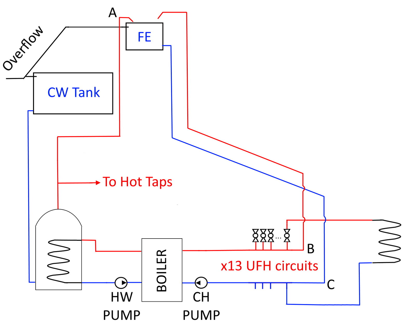

I’m hoping for some advice regarding a somewhat “unique” heating system, but appreciate this might be a bit of an odd one!
I’m familiar with S plan, Y plan, even W and C plan. This is not that...
Essentially it is an non-condensing traditional heat only oil boiler (no internal pump) with four tapping ports on the water jacket.
Two of those boiler ports are used for CH flow and return, circulated by one pump which feeds an open vented UFH system (that’s probably a topic for another day).
The other two boiler ports go around the water cylinder, circulated by a second pump.
It’s not a converted gravity system, just a straight loop.
I suppose a bit like a pump plus system, but made from two entirely separate pumps directly from the boiler.
No NRVs. No motorised valves. Pumps are controlled via relays.
It has been in for long while, and obviously works as far as stuff gets hot. But it has some issues on the CH side.
Ripping it all out and starting from scratch isn’t an option, but some amendments are going to have to be made.
My question is, I know it is unconventional, but are there any glaringly obvious problems with leaving the HW part of the system as it is?
I was wondering if the boiler itself will act almost like a low loss header to provide sufficient hydraulic separation between the pumps?
It should act as a LLH.
Are the pump relays controlled by a cylinder stat and a CH stat?,. does the UFH have a pump and thermostatc mixing valve on its manifold ?

A rough sketch of the system would be useful, especially showing the vent/cold feed arrangement, and the position of the pumps etc. I have a 53 year old oil fired S plan system with some rads greater than 40 years old and pretty sure that at least some of the pipework is non barrier, its a combined vent and cold feed and the water is perfectly clean even though only the odd drop of inhibitor has been added over the years, the circ pump is pumping into the boiler return and the vent is carried on up from the T off into the cylinder coil top (flow), the cold feed is then fed directly into the vent, below.

Thanks for the replies, I've attached a simplified diagram of the system as far as I can ascertain at the moment. I'll apologise in advance, it was just a quick sketch!
I've had to make some assumptions as a lot of this stuff including all the heating manifold is buried inside walls and cupboards so it will take quite some time to trace.

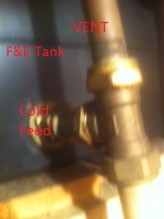

A - is a pipe labelled HW bleed in the loft, I'm assuming this is a vent from the HW tank as it is a vented tank.
B & C, looks to be how the vent and feed are connected but very difficult to tell.
I'm pretty sure you can see some issues already, but it is worth noting B & C are not likely not within 150mm.
* A & B are just poked into the top of the FE tank.
* FE tank sits on top of CW tank.
* Yes that is how the overflows are connected.
* System was installed as part of a self build/renovation by them.
I've spoken at length with them but they can't remember how they installed any of it or where anything goes.
* Its been in approx. 30 years, but altered several times in that period including moving HW cylinder downstairs and boiler and pumps outside to a new plant room.
* Piped almost exclusively in Hep2O. 22mm to manifold, 15mm loops for UFH.
* System does seem to heat rooms and HW fine (or did before boiler failed).
* The system is on either boiler #3 or #4, all failed due to water jacket corrosion. System was filled with inhibiter.
Old one has just been removed and new one is a Mistrel KU2 20-26kw.
I think it’s fair to say the CH system is likely going to need some work, but if the HW side is mainly OK that would be a start at least!
Thanks for your help.

I think there was a lot of oxygen in the system, could a lot of that be down to the CH pump on the return putting the system under negative pressure?
I did think it would probably need some sort of vent on the HW loop, tank is still sitting slightly higher than the boiler.
Looked to be set to around 60 degrees. Old boilers were non condensing, new one is also non condensing.
If the dT through the CH system is 20C then the possibility of a return temp of 40C, may be a problem, you can buy a clip on thermometer and clip it on the return, close to the boiler
I dont think installing the pump(s) on the boiler flow on its own will make any real difference as the pressure drop through a oil fired boiler is negligible, a few ins WG., if you do reposition it then you could install the traditional VCP system, from the boiler, Vent, Cold feed, (no more than 150MM "away"), and Pump, however this means running two independent pipes which even then might not cure the problem, the combined vent and cold feed works in 99% of cases even where the VCP system hasn't.
No blending on this, it is just two banks of tees, one for feeding the UFH loop and the other for the return, which is then circulated around the boiler. I don't think the UFH does run at a lower temperature in this case, at least not intentionally.
Looking at your drawing, the pump could be pumping over. There may in some cases be a spurt of water at pump start or continuous discharge from the vent pipe. a visual of this will be possible at pump start and if pump speed is increased. Pumps used to be located on the return in olden days but now does not matter
Underfloor pipe has a foil barrier so protected against air ingress through the pipe wall. Some plastic pipes for hot and cold services do not have a foil barrier and this type of pipe is to be avoided for central heating use. There is a brown pipe called Bartol this is really bad for air ingress.
Yes the system used to violently pump over, but I understand this has reduced since the pump and boilers were moved.
This was all done in the original non barrier grey Hep2O plastic pipe for all CW, HW and CH loops.
Issue will still be there as configuration in the picture has resolved nothing.
For a start, point C needs to be between the pump and the boiler.
