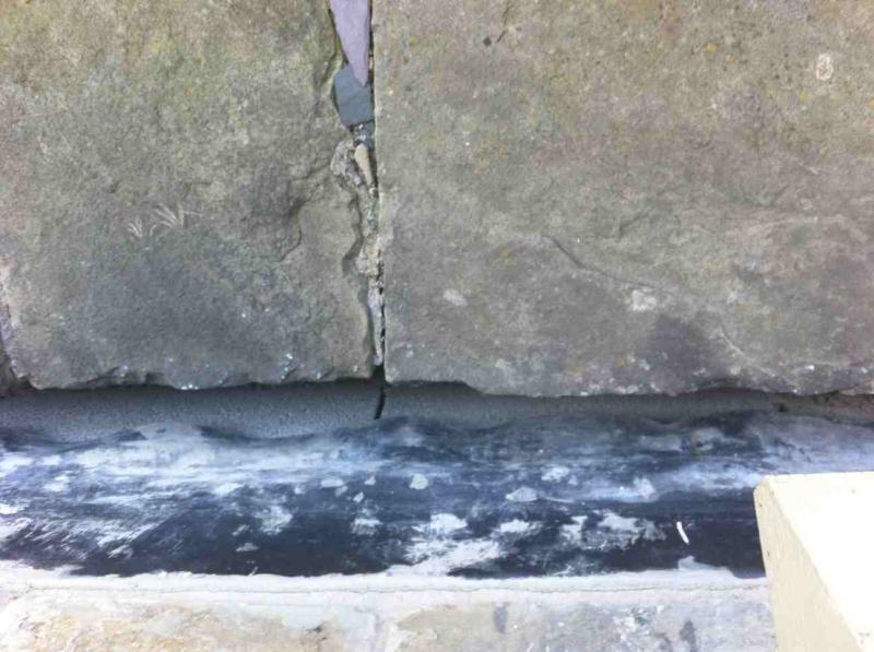

I hope that link works! Its not the best photo but the tag explains what you are looking at.
The Top is the actual top of the boundary wall between my house and my neighbours garden, looking down from above. The bottom is some lead flashing that is present where the brick changes to concrete block (at the level of the top of the boundary wall). In the gap you can just make out the concrete blocks which extend down for about 6 feet and are pointed quite badly.

So are concrete block not drawing and porous?
How could you seal the wall indeed and how would you have expected a builder to do a better job when the only way access can be provided is to take down the boundary wall?
External skins are not impervious to moisture/water ingress whether they are rendered or no although render will go far to prevent water ingress. Again re-read my post about cavity walls, everything there is still relevant and should allay your fears. Given that there is a dirty great existing wall in front of it certainly no wind driven rain is going to get through the wall.
