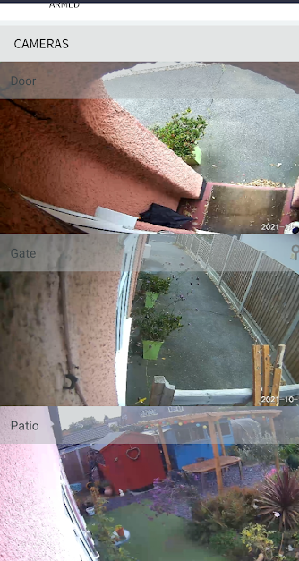

For a cheap and cheerful solution, I used Neos cams. They are wifi, powered by USB cables, and data is stored on the cloud. You get a little for free, or pay about £3 a month for more storage. Records in sections on 1 minute based on movement. The cameras are £25 each, plus external mount. They are designed for indoor use, but had mine running for a few years now with no problems.
https://shop.neos.co.uk/products/neos-smartcam
The app is easy to use.
App view
There's probably lots going against this sort of set up, but it's cheap and easy. Has night vision too, and you can set sensitivity and motion zones
