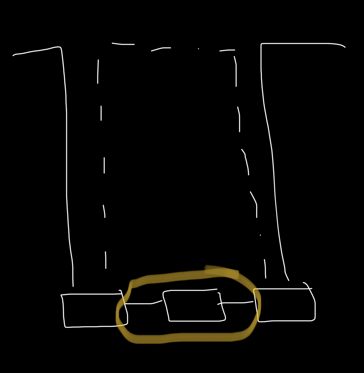

I’m adding a socket to a kitchen wall, there are currently two, both on a ring and fed vertically from the ceiling
I have added an extra socket in between (highlighted in the picture) and now the cables drawn as dotted lines are no longer required.
What should I do with them?
Cut them flush at the box knock out? Terminate them with connector blocks?
I was thinking of joining the brown, blue and earth together to make it obvious they are not live
25mm back boxes so not much space

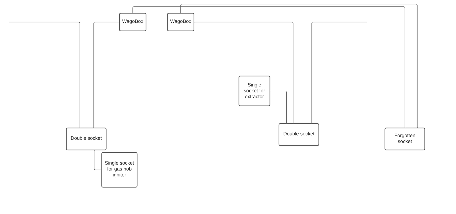

This was indeed the case; I had forgotten that I had added a socket to the ring in the section I've disconnected.

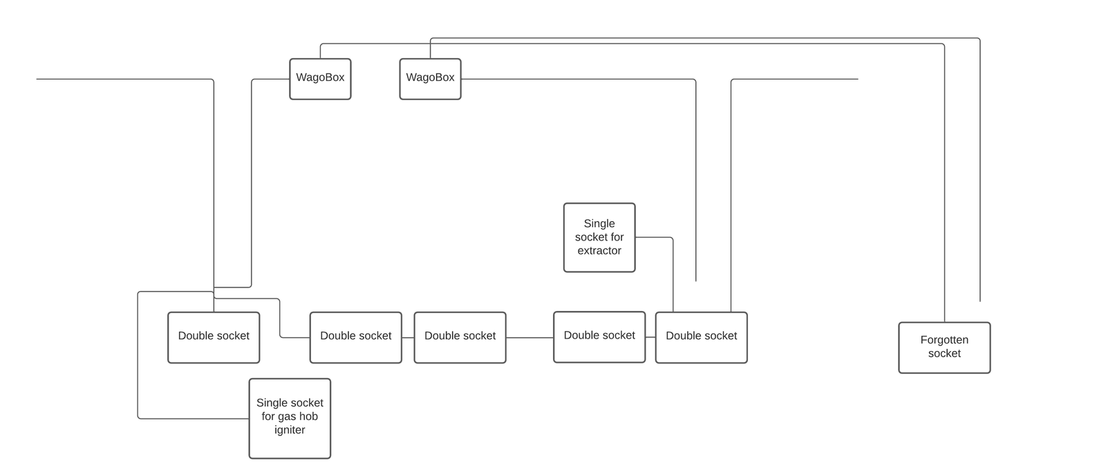

Here is the original layout

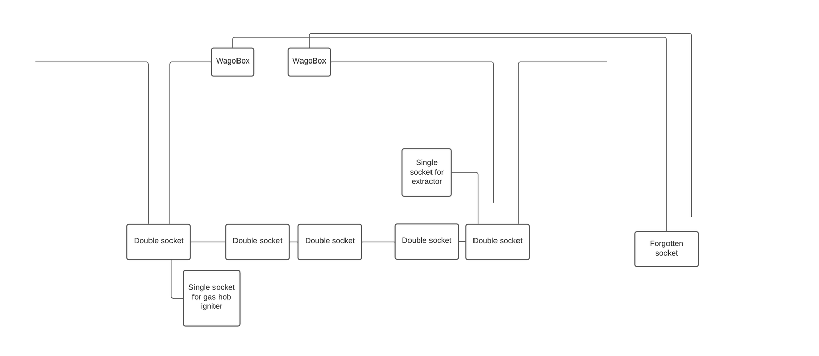

The modified one
And the solution I've found to revive the forgotten socket, which has now become a spur
The problem is that the double socket on the left has now two spurs. I could spur the single socket from the double socket next to it instead, which I think it would be fine in terms of regulations, but the socket is so close to the other one that it will make very little difference
There is not a problem with two spurs from one socket.

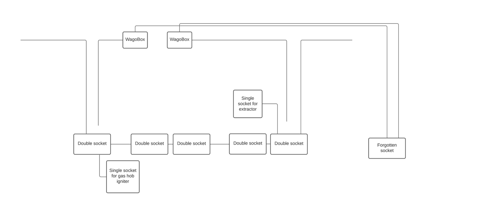

I didn't! To be honest, I've stuffed everything in 32A rated wago connectors and run single wires to the socket.
Strictly speaking I have 3 spurs from a single point on the ring (altough one is only 10cm long) rather than 2 spurs from a socket on the ring.
You could have connected the four cables at the socket in a certain way with the wagos, using some short pieces of wires.
So, you could have had one ring wire, one spur wire, and a link wire to the socket spur
and
the other end of the link wire, the remaining ring wire, and the remaining spur wire to the wago
and the same for all two sets of wires.
Got to be easier for the next man to deal with.
That said, a decent pro would be able to get 4 cables into a double socket neatly and securely.
