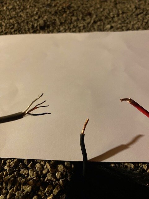

I am planning to get a spark to do an EICR but before that I wanted to get an understanding of what I have in my house so I can be prepared. The house was built in the 70s and has the usual additions on additions; so far it makes sense to me but today I found some wiring on one of the lighting circuits that looks very odd. There is a soldered connection which I believe to be the neutral wire coming back from a light fitting connecting back to the circuit (normal so far) but also soldered here is a 3 core and earth wire, looks like 1mm, and ALL cores are soldered to the joint. I know for a fact that this connection is required to make the lighting ring function correctly. This is an old wire certainly (red, black and grey). But does this make any sense? Why would anyone do that? As I say, I will get and EICR so perhaps this question can be answered then.

Apologies, I used the term 'ring' incorrectly and edited the post accordingly. Sorry for the confusion. I attached a photo; imagine the three cables you see are all soldered together including ALL the cores in the smaller 3 core cable (this was how I found it). As I say, I will have someone qualified do a proper inspection but I wondered before that if a) this is in any way typical on a lighting circuit and b) if it could be dangerous.

What does it look like in the fitting. By soldered together do you mean all cores in each of the wires?
I cannot easily trace the wires all the way but I believe the red wire is the neutral coming back from a ceiling lamp. And, yes, all the cores of all wires in this picture were twisted together and soldered.
I removed that joint because it was in a terrible location and reconnected using a connector block. But it seems very odd to use a 3 core cable in this way; I suppose all the cores are shorted together as if they are a single core?
This is clearly very old wiring, I am guessing perhaps that the spark at the time had some spare 3 core cable and decided to use it like this?

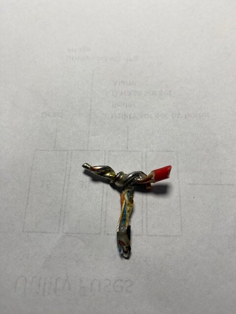

Additional: I took a photo of the removed soldered joint where you can see all cores twisted and soldered. This looks pretty terrible to my untrained eye.

Looks amazingly dodgy to me! I‘m fairly certain the 3-core isn‘t meant for mains wiring and the person who installed it knew that. The cores are much too small and the original bodger tried to circumvent that by using all three in parallel. Needs to be replaced completely.

Unless you can trace where the wires lead to and replace them with a single neutral core and jb (if that is what is required) you will need a sparky, so it makes sense to leave it for the EICR.
Thanks all. You have confirmed there is no sane reason to do this, simply a bodge. I will accelerate the EICR!
