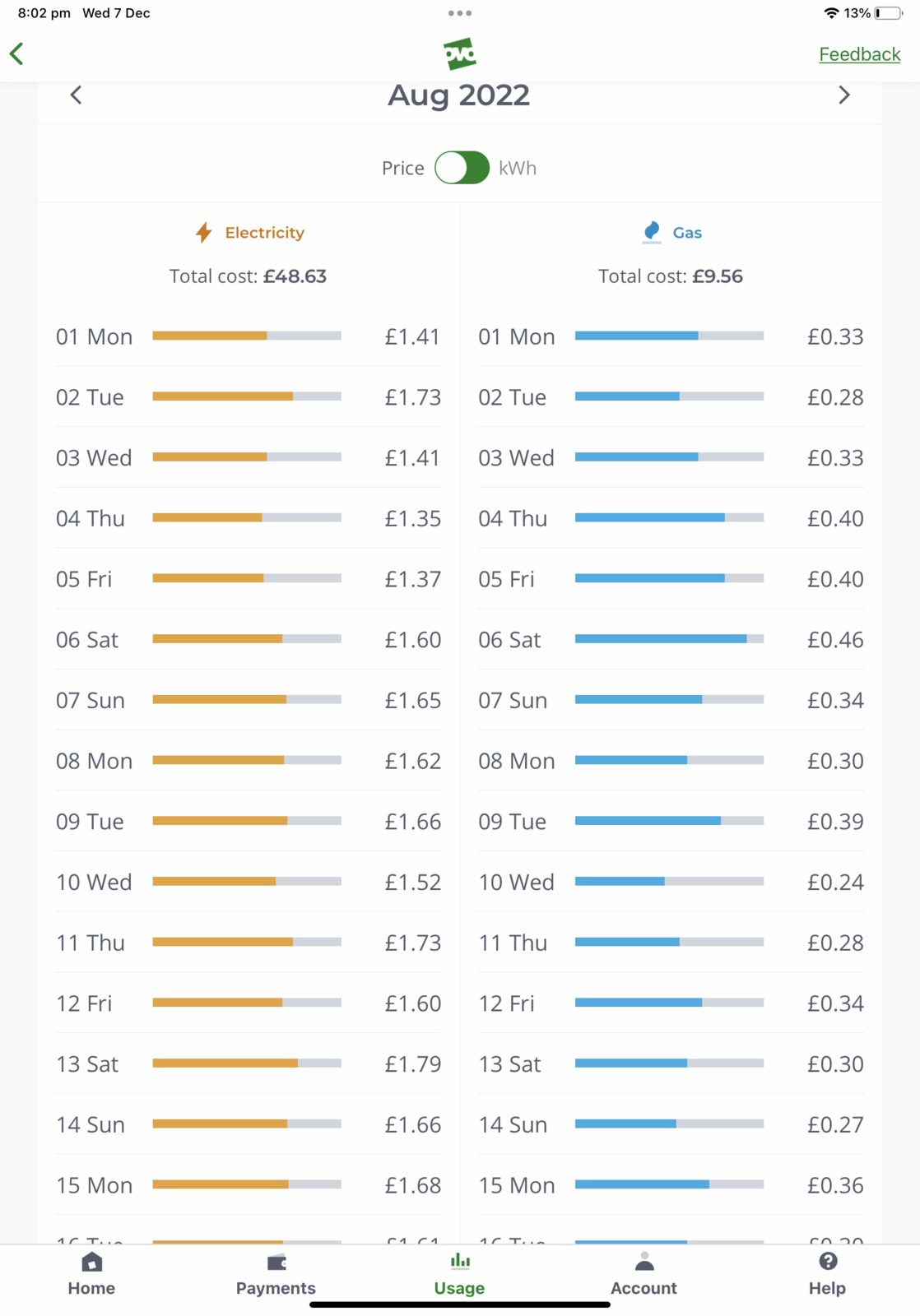

In the summer when the heating is off, the only gas used was for heating the hot water and our gas hob for cooking. Even then, our gas usage averaged around 35p per day. Hardly seems worth getting solar panels to save that amount.
