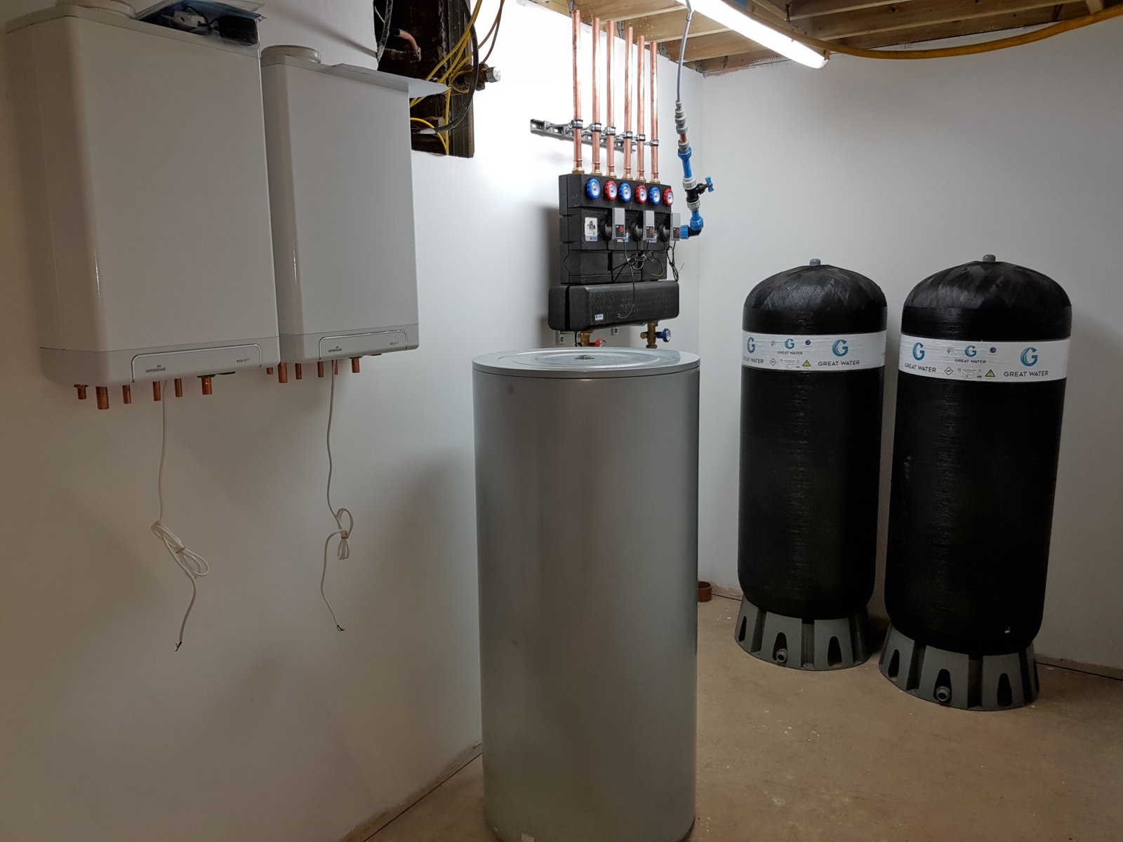

You replace the cold tank with an accumulator(s) depending on volumes needed.
Hot water cylinder is replaced with an unvented cylinder.
You then get mains pressure balanced hot and cold with no pumps.
The cost is dependent very much on what is needed and what grade you go for and how much work is involved.
This system cost a fair few sheckles:
But unless you are showering 4 or 5 people simultaneously, you can do things cheaper.
The example in my videos which does a family of 4 and included a boiler installation was just over £5K+VAT.
Plumbing was pretty straight forward though and prices vary heavily with location etc. (I hate giving figures online because of this).

If you have a cold water storage tank then removing that in favour of accumulator(s) will by definition result in a balanced supply as that is where you cold is fed from as well as the hot.
But if both hot and cold are supplied from the cold water storage tank then they will both be at the same, balanced, pressure.

What safety devices do you think are on accumulators?
I would have thought a pressure relief or pressure control valve may be needed to deal with the unlikely event of the mains water presure exceeding the accumulator's safe working pressure.
Also don't accumulators have to have a membrane separating the air chamber from the water and doesn't that air chamber have to be pressurised to an optimum pressure using an air pump. What happens when the mains water pressure is lower than the air pressure and the accumulator is empty of water. ?
