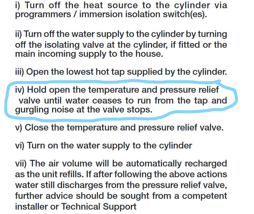

Yep, just had a look at the MI and the expansion relief valve is 8 bar, it's just that's unusually high. The max you usually get on the control set is 6bar.
I would recommend a service of the cylinder, as @muggles comment. It is important that these cylinders are serviced yearly, same time as the boiler would be the ideal.
That procedure doesn’t tell you when to turn the tap off.
