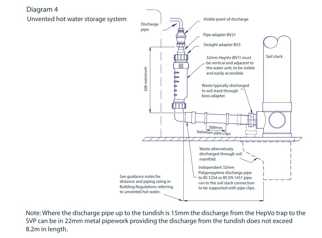

Is there anything in the regs that state it cannot go into a soil stack?
There are two possible discharge sources!
The temperature and pressure discharge with strict regulations!
A 6 bar plain PRV from the cold inlet to the cylinder. The discharge from that can go almost anywhere as it will always be cold.
Note the pipework MUST be Polypropylene and use PP push fit fittings for their high temperature resistance.
All work to be done by a G3 qualified installer.
All plastic that is part of the T&PRV must be high temp resistant (certain PP/PE/PVC-U) plastics. Not all waste/soil pipe is suitable as it won't take the heat if a T&PRV goes off dumping water @ >95deg.
You may find your soil pipe isn't suitable and can, in effect, melt. If both of the dump valves are tee'd into each other before the tundish, which a lot are , then the D2 run and downstream will need to be heat resistant.
Plastic Standards can be found here -
https://www.bpfpipesgroup.com/media/20922/Discharge-from-unvented-hot-water-storage-cylinders-into-plastic-sanitary-pipework-systems.pdf#:~:text=Given the high temperatures reached during valve operation,,be to connect to a soil pipe manifold.
