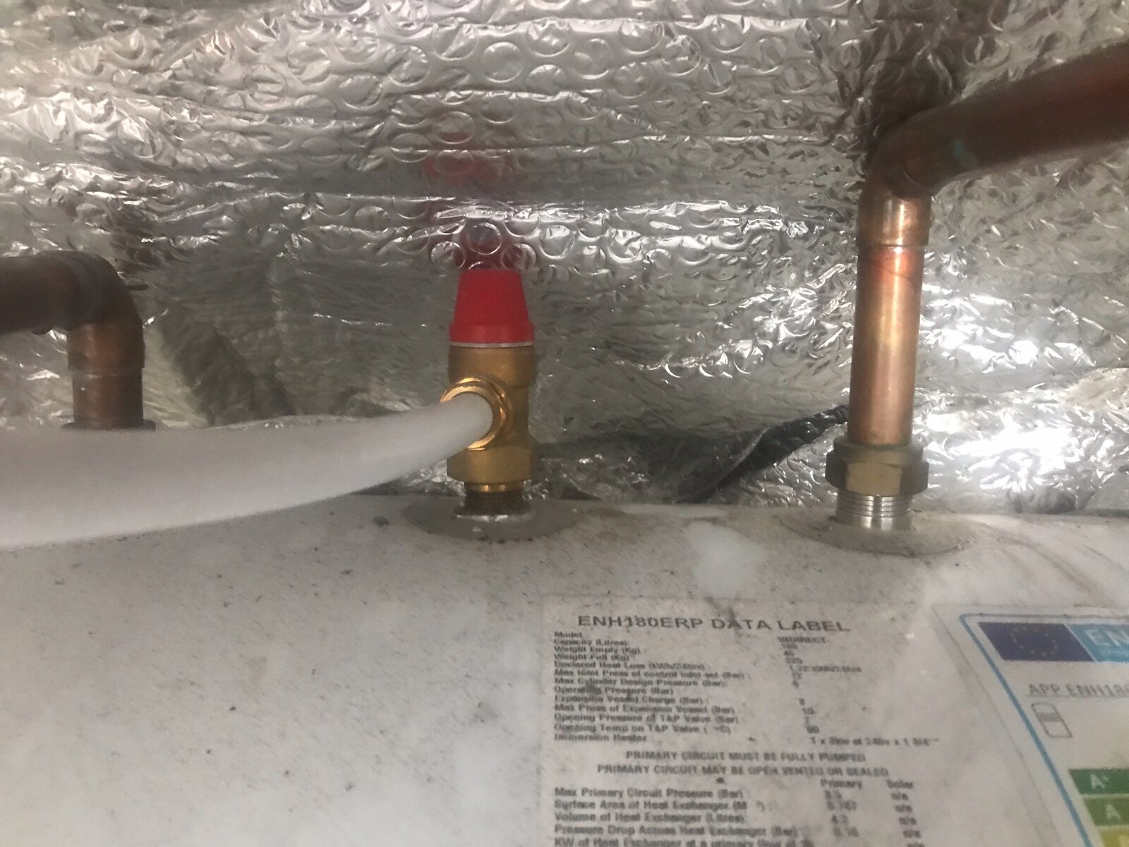

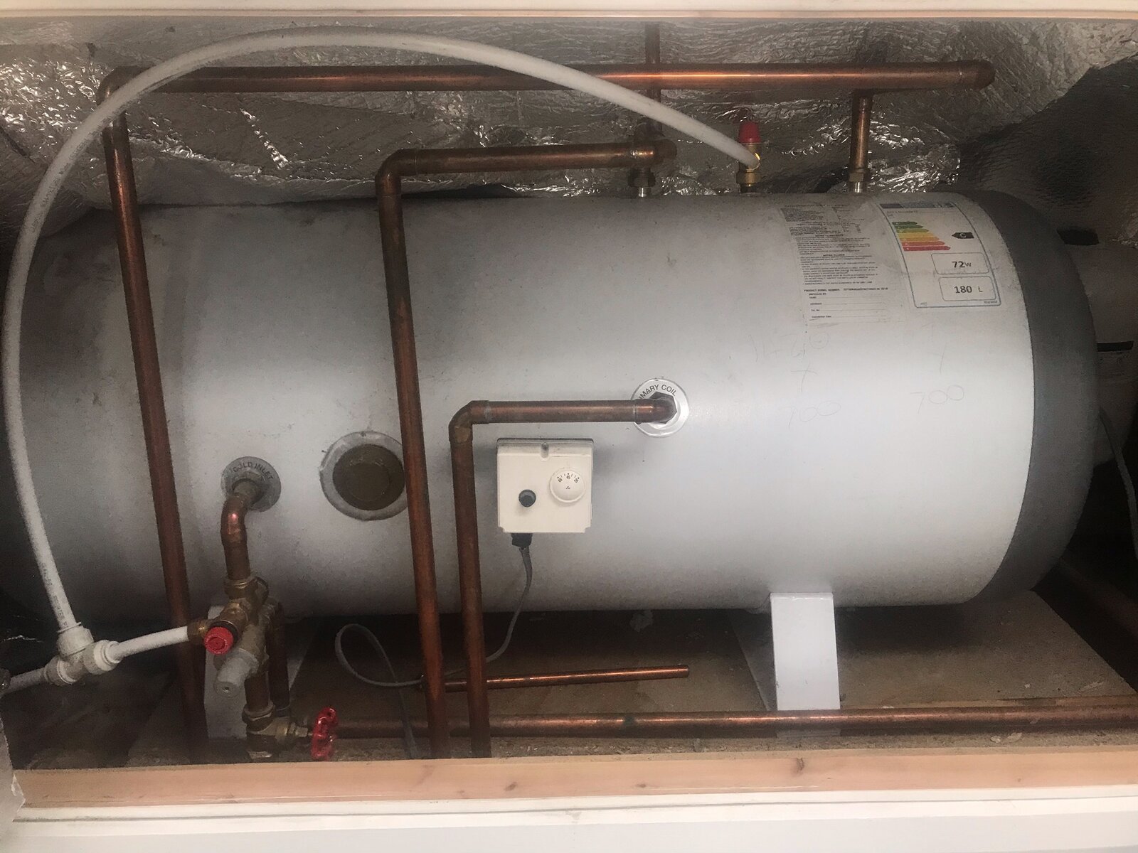

here are some pics of what I have.
White pipe is overflow.
Red hand wheel is cold water supply
This shows overflow coming off top of cylinder

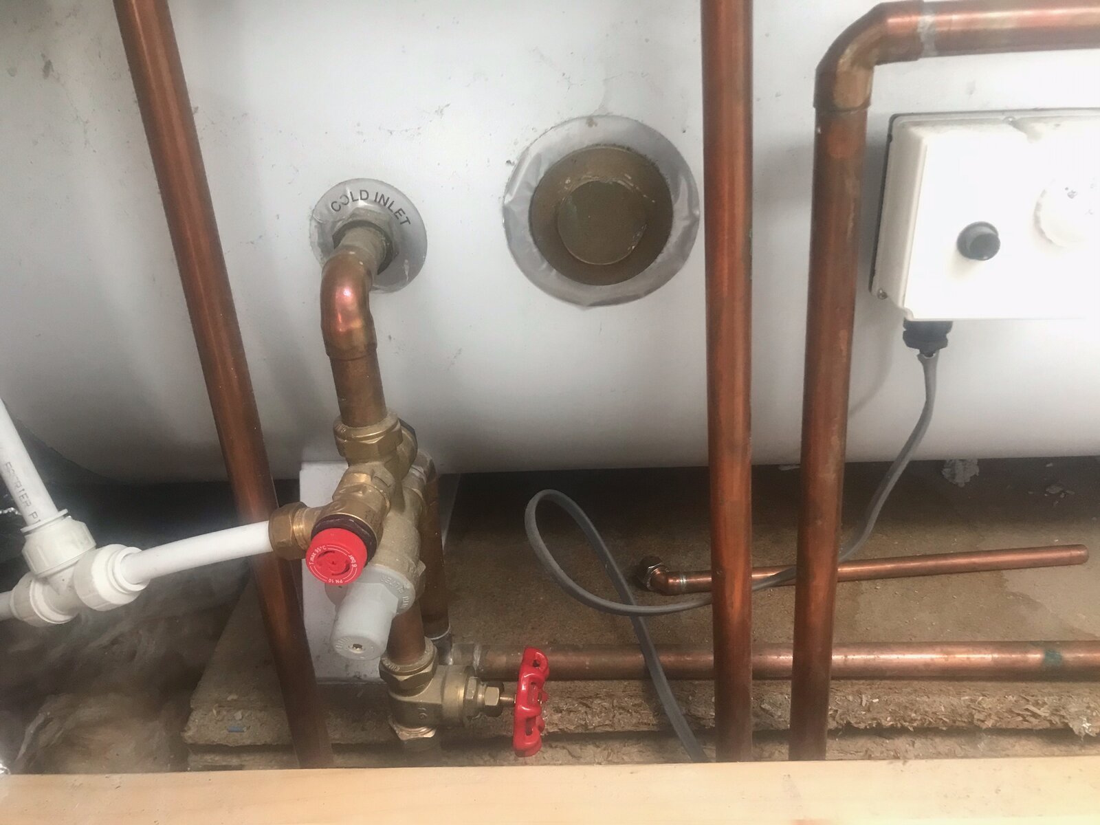

Overall view. expansion vessel off to right - not shown.

Oh dear, that's just plain wrong.
Has the benchmark in the MI been completed by the chap that installed it? That install isn't right. I would hazard a guess that if it isn't filled in then the chap may not be qualified to fit UV cylinders. Do you have a BC (building control) certificate covering the install?
Can I please ask you to turn off the hot water until you can get a qualified engineer in to check it over and sort it out. That's an accident waiting to happen, unvented cylinders can be very dangerous.
As @Madrab says so many things wrong with that install, turn off the supply and open a hot tap and dont use until it is installed correctly
The 2 key safety devices need to be re-plumbed properly a tundish introduced and disharge pipe upgraded and run properly. The stop tap ideally needs changed, a gate valve isn't really designed for mains water. Your qualified chap will know what to fix and what to sort out to stop it releasing pressure.

Stop using the cylinder..it's unsafe. Who installed it...they can be prosecuted for such illegal work.
Get a G3 licenced installer and at least the following needs checking/doing...
Who's stolen the immersion heater...needs installing/wiring for backup.
Expansion vessel plumbed into the wrong connection.
Check the expansion vessel pre-charge pressure.
No balanced cold take-off by the look of it.
Needs a proper full bore ball valve for inlet isolation.
Raise the pressure reducing valve/expansion valve inlet set above the cylinder for easy maintainence.
Check there's a drain-off on the cylinder.
Re-do the safety valve pipework and fit a tundish and check where the termination is.
Re-do the cabling...twin & earth is not acceptable.
Check all the wiring and controls...highly likely to be non compliant.
Insulate all the pipework.
Check the structural support...chipboard is not really acceptable.
Fill in the cylinder label and notify to building control and receive the control notice from them.
etc etc....
Shocker. Very frustrating to see knowing that 99% chance of no comeback to installer.
Looks like expansion vessel may be off the balanced cold connection prior to check valve. Doesn’t matter what pressure is in that vessel, it ain’t gonna change anything!
Looks like the kind of install you'd see in a training centre, with an assessor breathing down your neck asking you to list all the faults on it.
