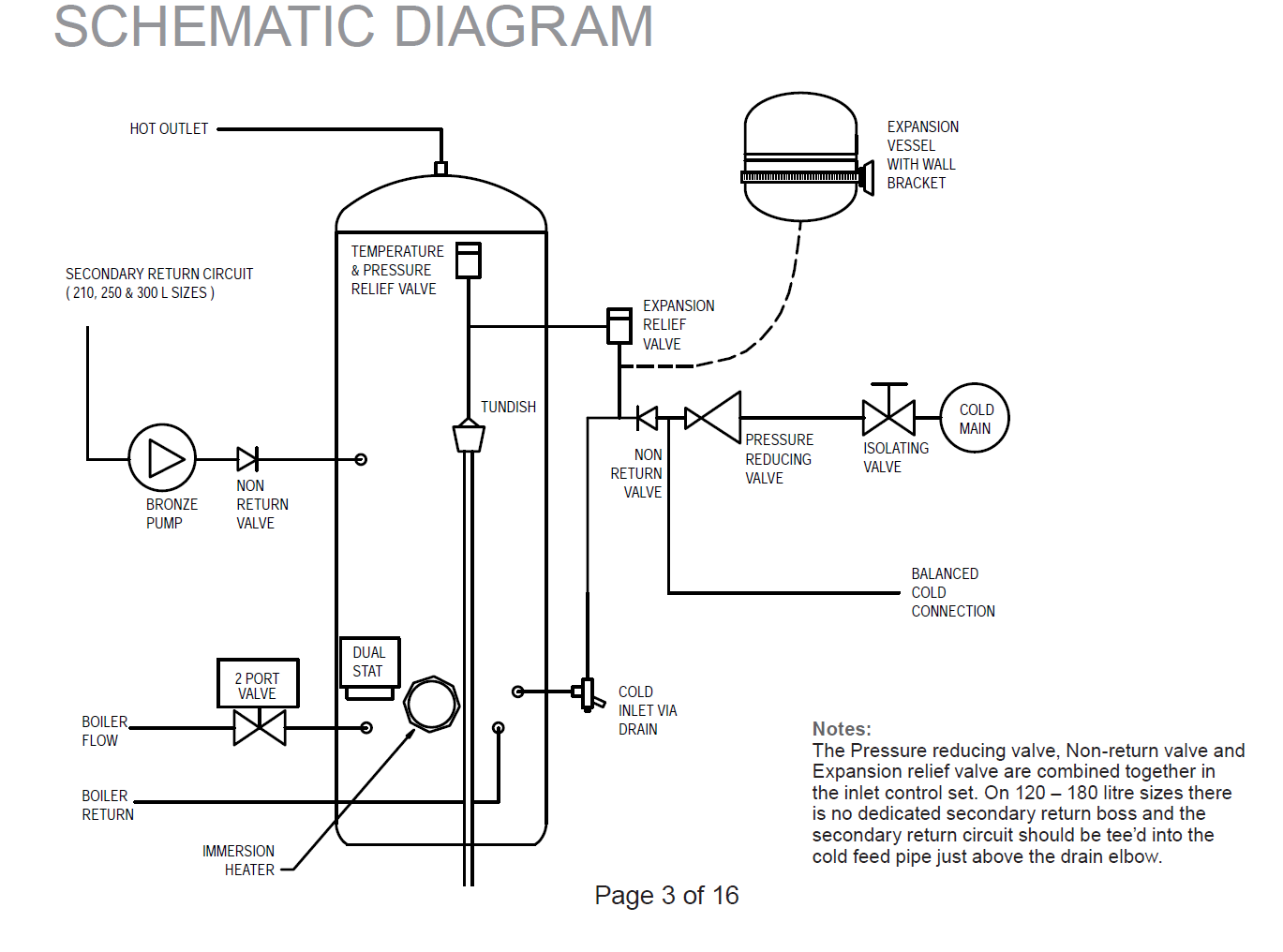

Assuming that the E.Vessel is OK and that the E.valve is not leaking but is only dripping when the pressure reaches 6.0bar then the only logical explaination is that the PRV is passing, the cylinder will have to reach ~ 4.7bar (cold) then the expansion will increase that pressure to 6.0 bar to lift the E.valve, the PRV will have to leak past ~ 4.8 Litres to achieve this which is not a lot over a period of time.
You can do a few tests yourself to prove this.
With heating off, Run off say 100L of hot water from a hot tap, then immediately shut off the cold feed to the cylinder and only then shut off the hot tap.
Start heating the cylinder, if no dripping from the E.valve after 20 minutes or so then the PRV, is the culprit IMO.

The expansion valve is the safety valve that's Set to 6bar in the combination group, as suggested can you remove the pipe that goes from this to the tundish to confirm or otherwise that it's this valve that is dripping on cylinder heat up.

Can you, as requested previously, remove the pipe that goes from the 6bar expansin valve to the tundish, this will then leave the relief port on that expansion valve exposed to view, you can then positively confirm (or not) that it is this (6bar) relief valve thats lifting when the cylinder commences heating.
There doesn't seem to be a balanced cold taken off your valve set, like the example below, so even though a remote possibility, its possible that the cold mains supply to other users, including thermostatic mixer valves is passing over through one of these if faulty ie a shower TMV and pressurizing the system back through the HW cylinder hot take off, this woudl mean a very high mains pressure of ~ 5 to 6 bar with no PRV (pressure reducing valve) on this supply.

I have just had confirmation that the discharge is from the expansion valve from the group inlet.
Its not from the TPR valve.
My engineer has now change his tune and advised me that the expansion vessel is faulty (i.e. no air).
In one hand i'm pleased to know that this is the route cause, but on the other i feel he's let me down in that the servicing did not pick this problem up (in fact i was told the vessel was fine, and they topped it up by 3.5 bar). Hence suggested that the expansion valve may be faulty and require replacement.
Fortunately he replaced this vessel about 3 yrs ago (aquasystem) which i believe has a 5 yr warranty. Now we wait for the replacement. There is still a question on who pays for the re-fitting etc.
