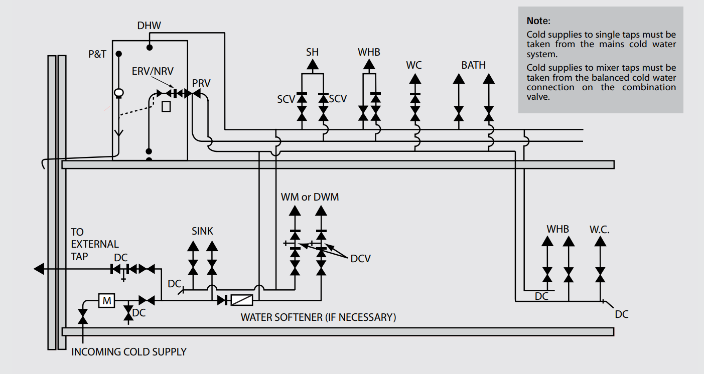

Unvented/G3 ongoing install sanity check
The cylinder manual will tell you exactly how it should all be installed, it really is simple...point out all the errors to this clown and insist on seeing the card.
Google the combination valve...it specifically mentions the vessel connection port, otherwise it needs teeing in between the cylinder cold inlet anx combination valve set.
Thermal stores store the water at much higher temperatures hence a blending valve to drop the temp down to 60 degrees...should not be needed on a standard unvented. Bath taps etc if protection required should have the TMV installed near the taps.
All this work is also notifiable to the council so make sure you get the certificate.

Its just occurred to me that there is another problem too. The balanced cold feed only goes to the vessel (incorrectly) and the TMV (not needed). The TMV then outputs a moderated hot, but where is the balanced cold going to?! I have a mixer shower that should be getting hot and balanced cold.

But the balanced cold should ideally feed all the cold taps and that's very important if you have an incoming pressure that's considerably higher than the hot regulated pressure.
Why is that? To account for future potential use of mixer taps that "mix in tap" as opposed to having separate channels?
Yes and the problems that can cause...it's feasible that you could have a mains static pressure of say 7 bar but the expansion valve is only 6 bar and therefore could discharge from back pressure via the cold.

To be fair, to pipe the balanced cold to every outlet in the house would be a nightmare plumbing job. For example the stopcock/mains feeds enters in the downstairs w/c, and the sink in their T's straight off it. How would you get a balanced there without ripping up most of the upstairs flooring.

The diagram shows a balanced cold feed to all outlets fed by mixers where there is the potential for the cold to back pressure the hot so no you don't need to feed WCs etc. Check valves are shown but they are often missing or fail to work. Note the absence of a vessel.

I think Jim's point is that you don't need to take the balanced cold to every cold tap which was the original comment. You are both right, considerations should be made for any mixer units.
