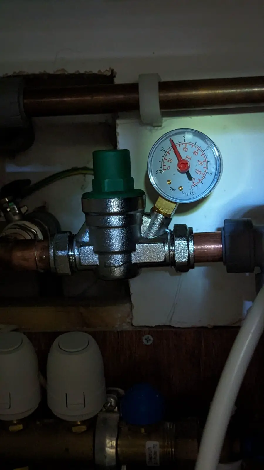

The PRV, above, may have something to do with what looks like a UFH system?.
The green PRV I believe is on the incoming mains - it should be set to the same as the unvented to allow any other cold outlets that aren't on the balanced outlet of the vale, to be balanced to the HW output.
The combi set is the right way around if the mains flow is left to right, running under the cylinder then up and back into the inlet.
should there be a lever ball valve between the PRV (including pressure vessel) and the unvented tank
Nope, there shouldn't be any valve on the inlet, downstream of the valve. It would allow one of the UV's safety features (the EV) to be isolated from the cylinder, the lever should be removed from that valve to stop tampering or moved upstream - (to the right?) - of the valve and gauge.
The supply with the blue lever valve looks like the balanced feed from the bottom of the combi set.
First place would be to balance the EV pressure closer to the dynamic pressure of the mains.

The red lever valve should not be where it is. The pressure on the unvented side needs setting correctly to the cylinder spec. The expansion vessel pressure should be set to the unvented tanks spec. The incoming mains pressure reduction valve needs to be slightly above the pressure set on the unvented cylinders pressure valve.

It would be useful to have the actual mains pressure even though the requlated pressure should reflect this if its 2bar or less, the pressure at the combination set PRV inlet (which is measured) should be somewhat less depending on the flowrate, pipe length and pipe size, the flowrate should also be measured.
