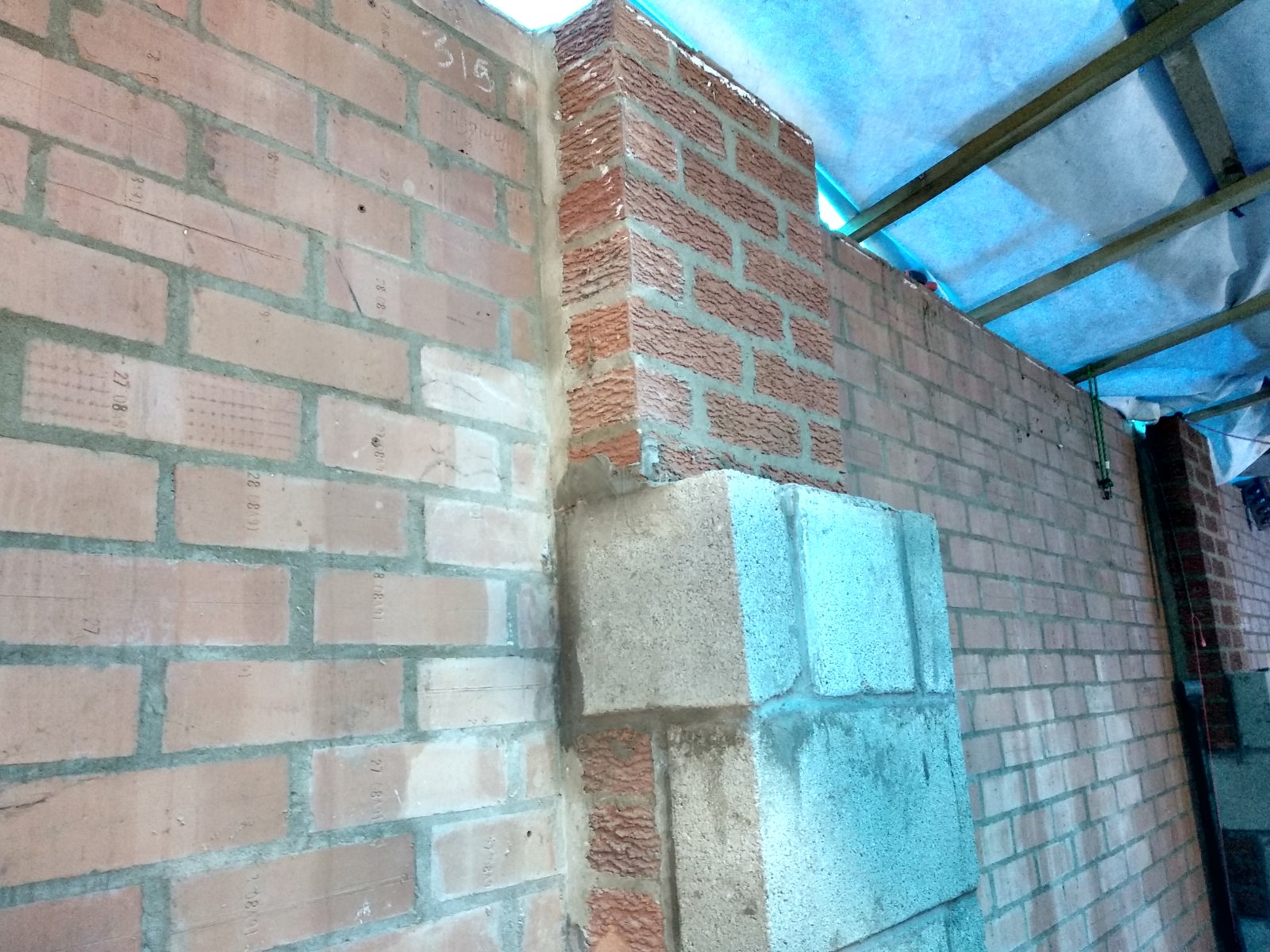

I've included a photo to show what I saw.
Hopefully it clears it up. I believe that the builders are planning to install the joists and floor immediately after the steels are in place so that they can start the first floor brickwork.
I noticed that the masonry hangers say to either top fix by using a hilti nail gun or to have a minimum of 670mm of fully cured masonry above them before they will accept any loading. That was the main reason for the worrying about securing them down. Is this the case?
Those hangers can go right on the top of the beam (no real need to hilti nail) or if there needs to be a bit of wall first then that should have gone off for a day, unless they dry pack the hanger and then build over it. As long as its all done with care to properly build in each hanger.

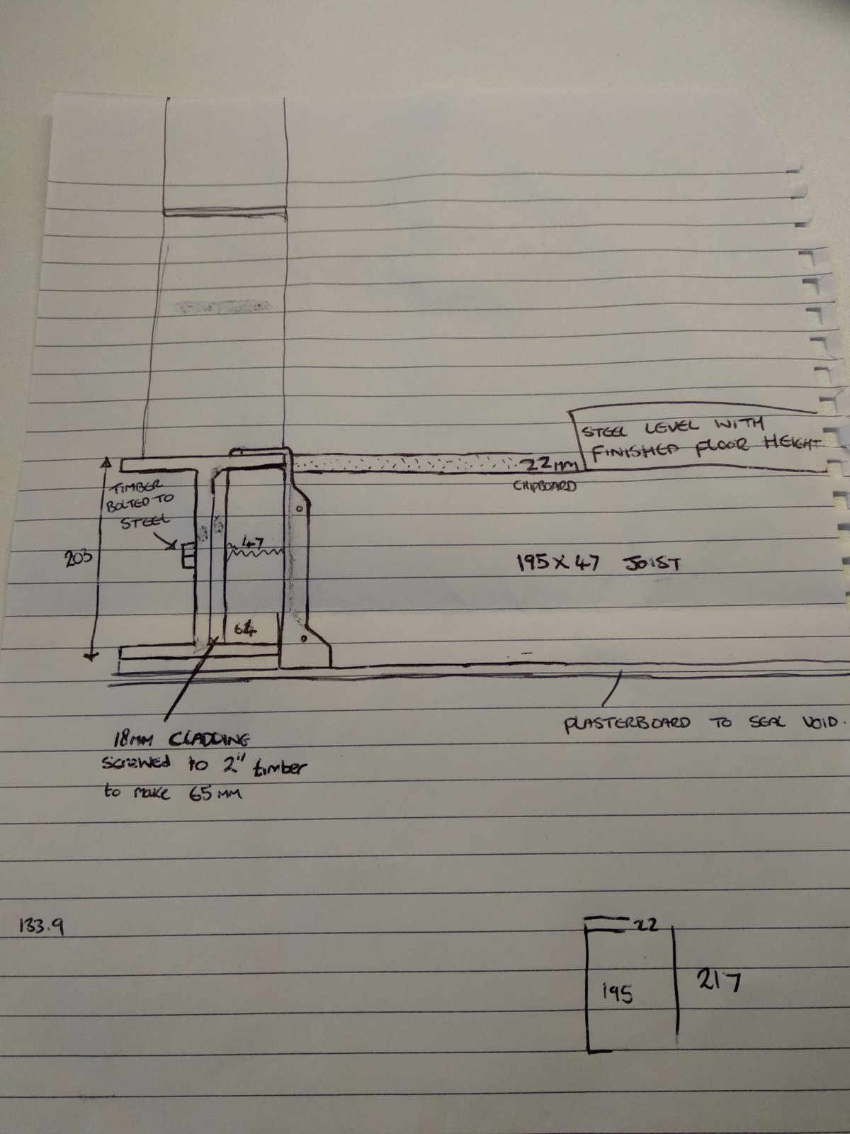

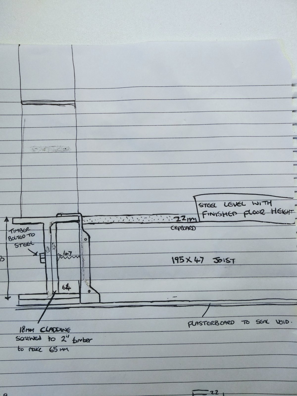

The thing to ensure, is that the hangers are deeper than the beam, as you cont want to be seeing an ugly boxed beam below the ceiling. If those masonry hangers wont acheive this, then you really need to consider lowering the ceiling level, or fixing timber hangers to a timber within the beam web. Or if the beam will project above the floor level, as it's 133 wide, then the wall could be lined to thicken it up to cover the beam width. This will all need to be considered in context of what is possible or important in terms of the levels or wall thickness.
So here's what I was thinking, I've drawn a bit of something to run it past you guys and see if it makes sense. Plan is (hopefully) to use a 225mm deep hanger which are 10mm short apparently making it 215mm.
The beam is 203 so that will leave a 12.5mm gap between the steel and the plasterboard at the bottom. As we're going off the piers I'm thinking that the steel will sit flush to the inner house wall and rest approx 30mm into the original double brick pier (hope that makes sense from the photo.
So a 195mm joist with 22mm chipboard will make 217 and leave the finished floor height level with the top of the steel beam, this should mean that the steel will be fully encased within the void and we achieve max ceiling height in the garage.

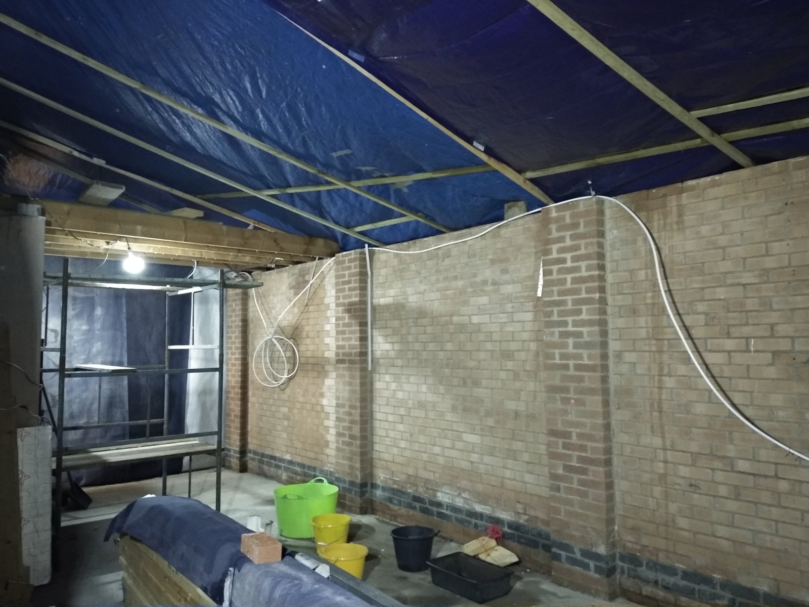

Do you mean the steel beam will only have 30mm bearing on to the brick pier :?::!:
I hope not! No it will be fully bearing on the 210mm brickwork beneath it, hard to see on the photo but the piers are now in effect 300 deep.
You've lost me, I don't see any piers 210mm wide or 300mm deep :!:
I should rewrite it really. The new steel is basically going to sit on a 220mm ledge (when finished). Should have just wrote that earlier
There are 4 piers to support the steel across an 8m length, each pier being 440mm wide X 220 deep

Morning all, can someone confirm that this is the best method of fitting the joists within the new insulated void. Does what I'm proposing make sense? Or is there a better way?
Can we additionally prop the joists with say 4 X 2 before the 3 courses of block are laid above to support them and stop and movement?
Thanks, Matt
Yes thats OK.
If you fix all the joists together with a lath or suchlike on the top or bottom near the hangers, this stops them moving

Steels in on Monday, they're planning on installing the steel via genie lift then building the piers up beneath it and removing the loft once all cured.
If the weather holds out..
Just an update and a few more questions.
Steels have gone in across the piers and the builders have packed them with slate but maybe only a 100mm square under each pier. Assuming they're going to mortar up the rest of the area but with there being a 440mm wide platform shouldn't more of this be used? Or is it ok to pack a small area then mortar the rest?
