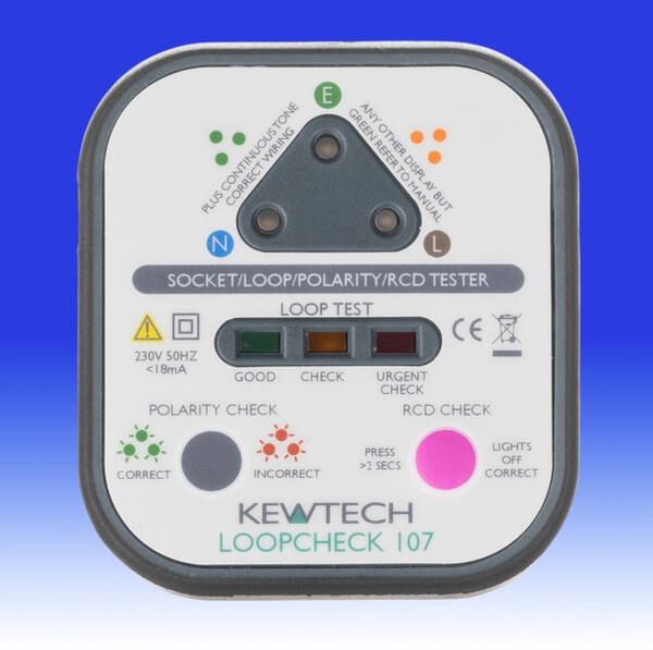

You can get cheap (£45) plug in testers 1709544676707.jpeg which state 1709544822062.png and will pass at 1.8Ω so only good for circuits below 24 amp. The proper tester costs around £60 to hire for a week. There are way to kid yourself you have done nothing wrong, technically a three phase distribution board is not a consumer unit, and a consumer unit with any item not listed by the manufacturer as being accepted with their type testing, makes it no longer a consumer unit.

@ericmark that plug in tester looks good, I didn't realise they did loop and RCD ramp test, I'll grab one.
