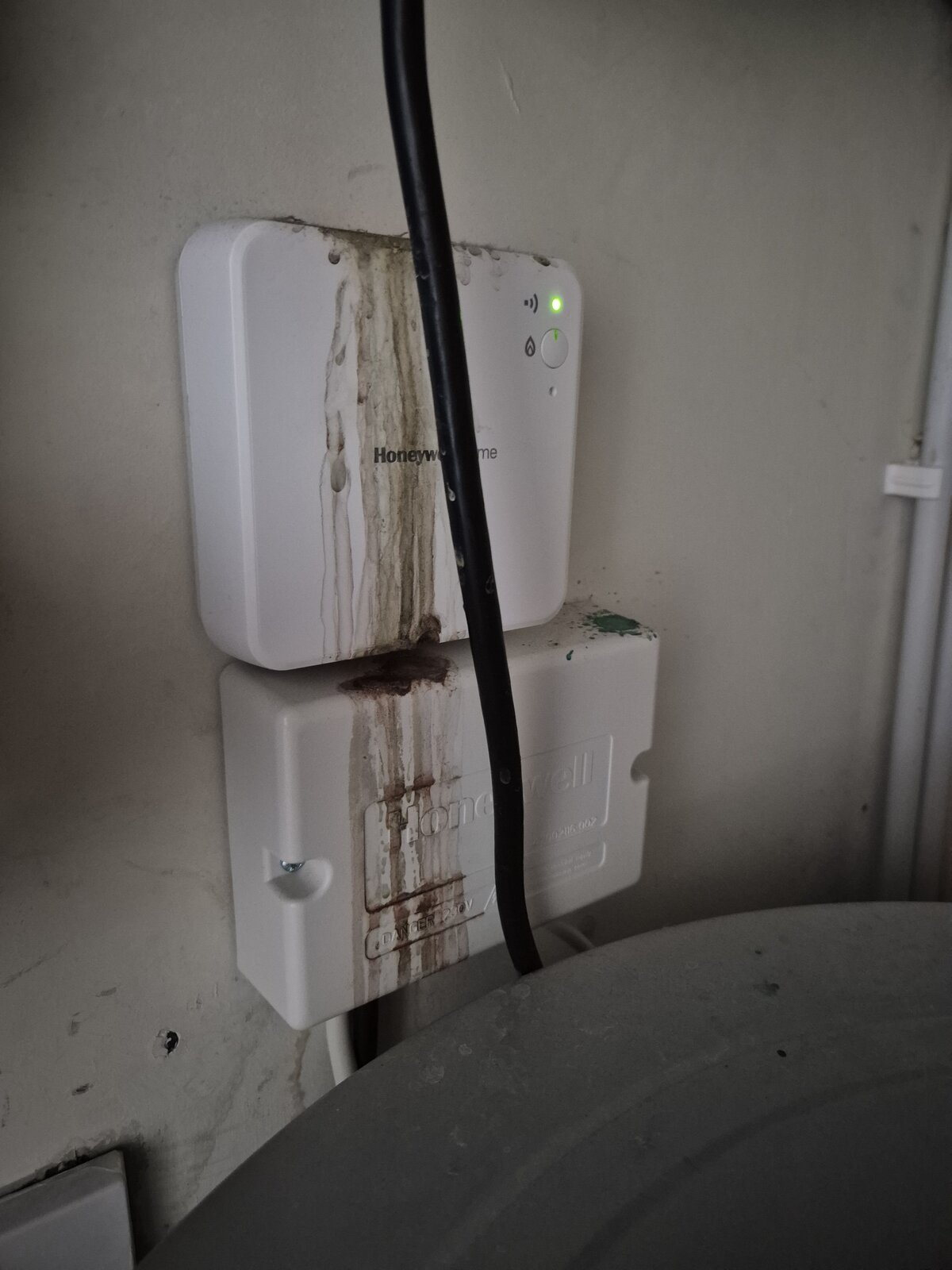

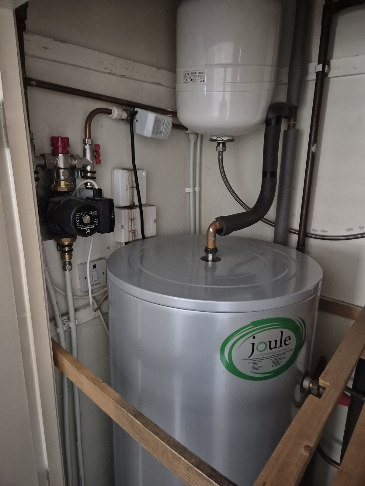

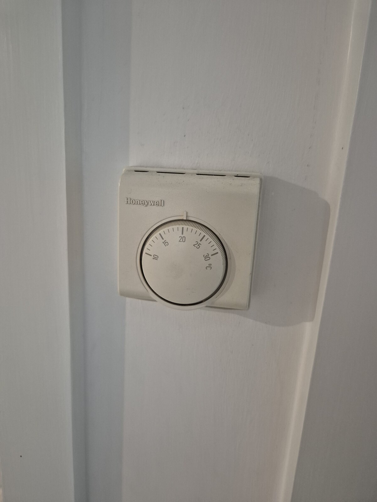

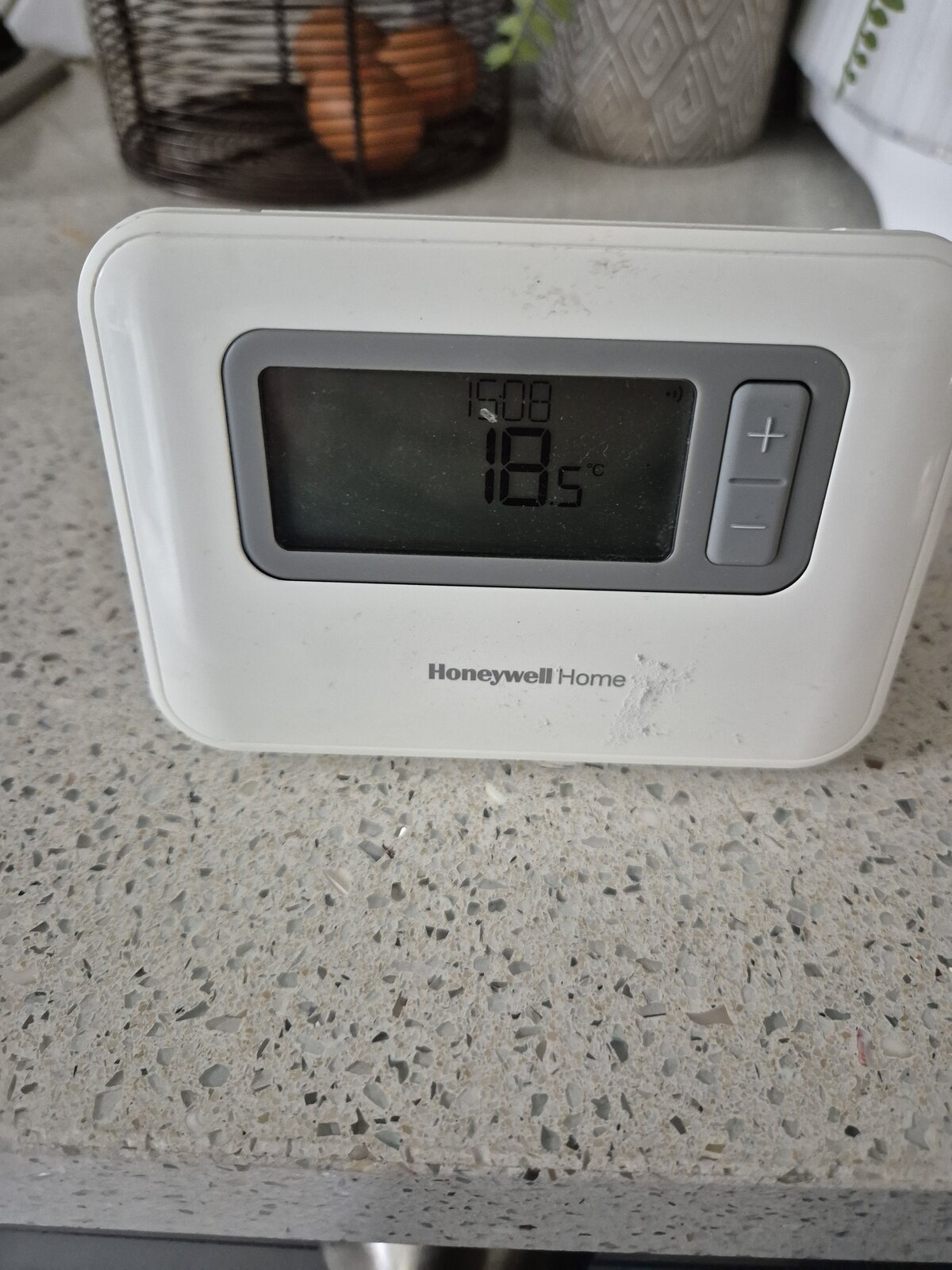

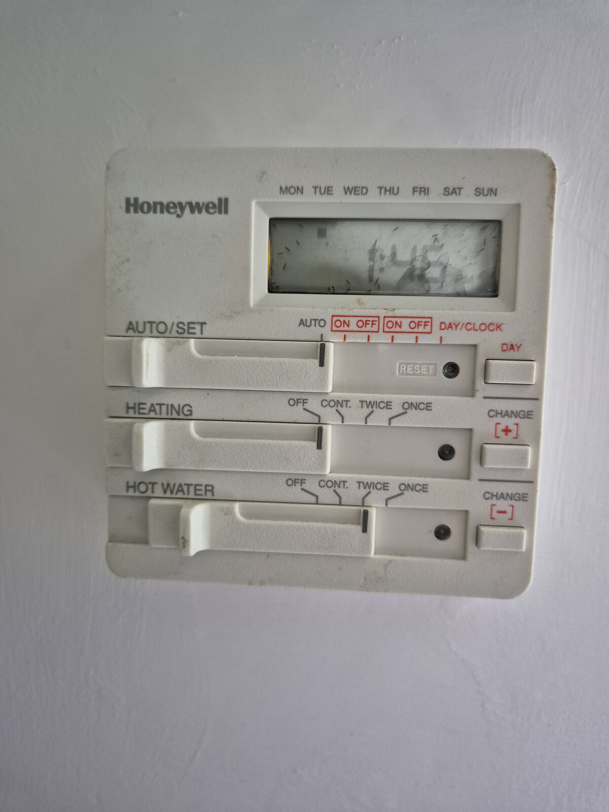

I've just moved to a new house and the heating system is a little confusing. We have an old dial thermostat which seems to control the radiators and a honeywell wireless unit that controls the under floor heating in the lounge.
I had a hive system in my old house and would like something similar, particularly so i can put the thermostat in my daughters bedroom so that the heating comes on when it reaches a set level in the night.

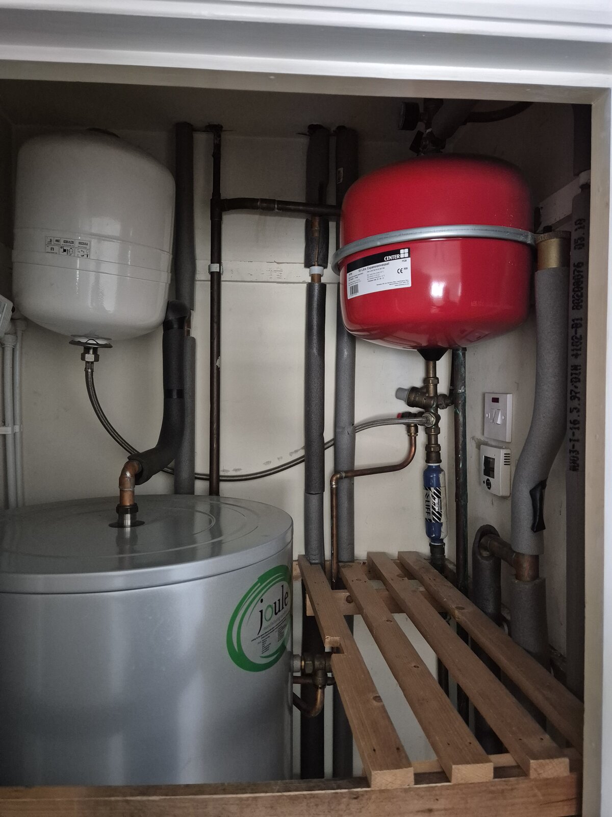

I installed that myself, as it was a combi boiler and relatively straightforward. This place has stuff all over (see pictures).
Whats the best way to do this. It seems there is already a honeywell receiver in the cupboard with the water tank(s) (complete with suspect stains on them), which i assume is driving the underfloor heating handset. Is it possible to just purchase another and connect so it does the radiators as well?
Appreciate any advice

It’s an unvented cylinder which you may need a G3 registered engineer if planning on a dual channel Hive, if not, then a single channel Hive should be sufficient.
Ok, good to know i shouldn't be touching anything. I did purchase a Tado X wireless starter kit to replace the Honeywell ST699, am going to leave the underfloor heating as is with it's own thermostat.
Will get a gas safe engineer to install it

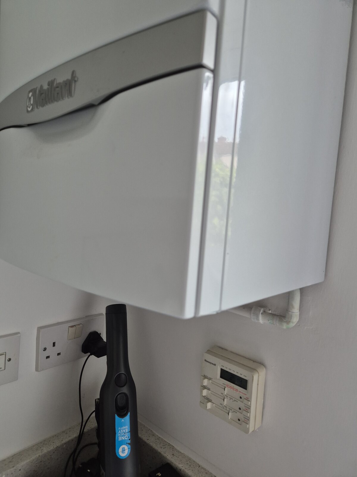

You have some sort of Vaillant boiler, though the model is not obvious. Vaillant offer some well integrated, and clever control system, which perfectly match their boilers. It might be worth your while looking at those, and they will replace most/all that you have there.
