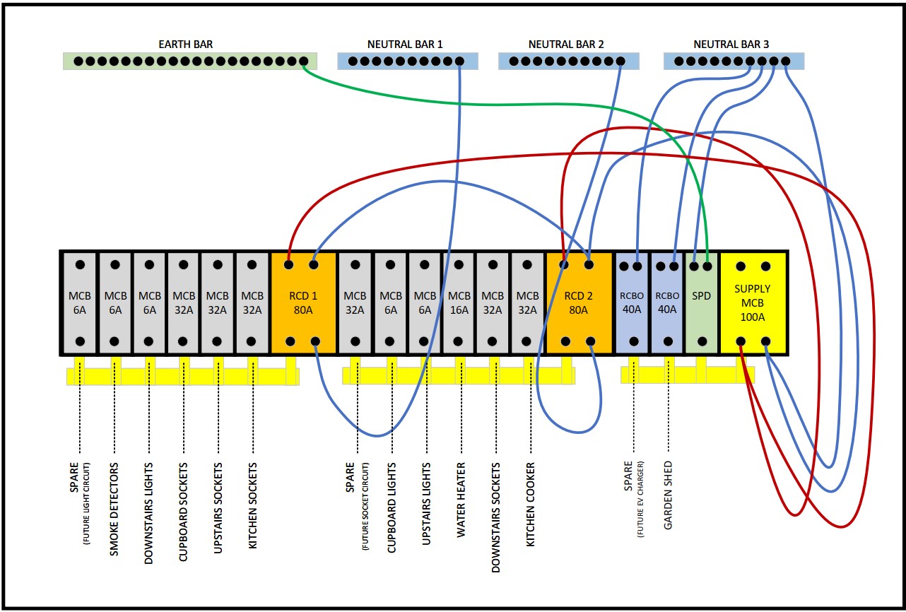

I am about to upgrade my Wylex consumer unit to increase the number of ways for future expansion and to include SPD surge protection and a new circuit for a garden shed using an RCBO.
I have a query about the bus bar connections when introducing the RCBO and SPD. From what I understand the Wylex SPD is wired in parallel, whilst the RCBO can be taken directly from the MCB.
Seeking advice on whether my approach is correct, thanks.

The top two terminals of the RCBOs are for the circuit cable L & N.
There will be a blue lead on the RCBOs which connects to the Neutral bar or supply.

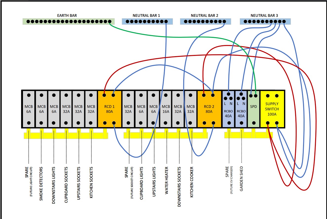

Ta, I've updated the diagram to show the RCBO terminals correctly. For simplicity, I am intentionally not showing the downstream circuit connections.

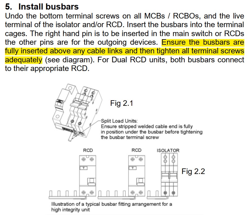

The Wylex consumer unit installation guide provides specific guidance on fitting the busbar, i.e. insert above cables on the isolator switch. I would have inserted it under the cables so I guess there is good reason for it. The illustration from guide is very similar to what I am trying to achieve ;)

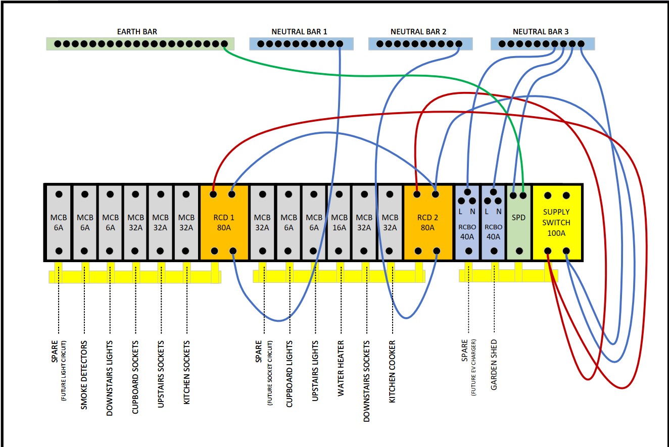

This Youtube video from John Ward is similar to my setup but in a smaller garage unit configuration. It's reassuring that my approach seems correct! Please feel welcome to share any other advice or comments :giggle: thanks
Do you realise that this work is legally notifiable to the local authority - before you start if not being done by a registered electrician.
