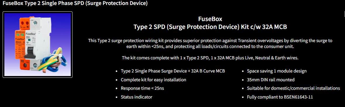

I'm becoming increasingly confused. In terms of what TLC are currently offering this single-module SPD plus a separate MCB ...

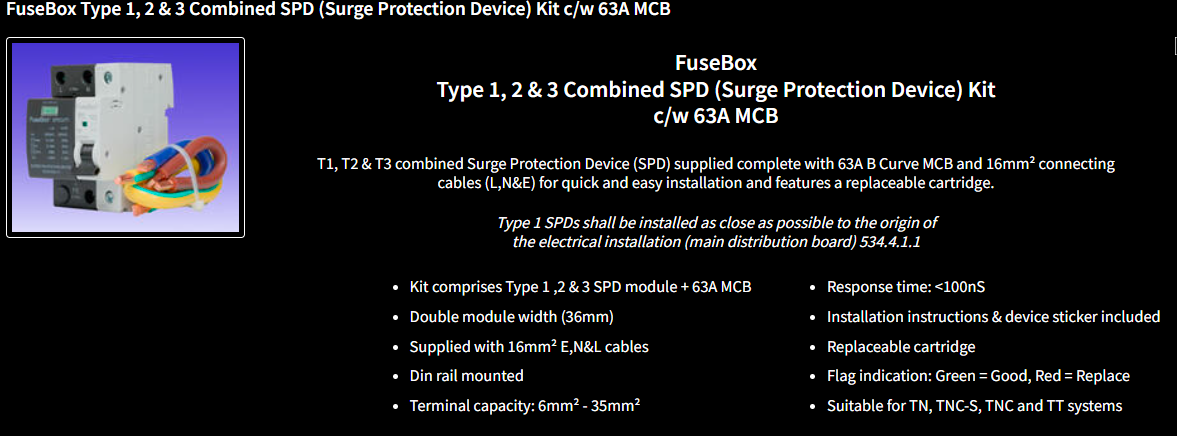

...and also this ("Type 1, 2 and 3") 2-module wide one plus a separate (63 A) MCB - so they seem to think (like most other manufacturers that an external MCB is required - so why not Wylex?
Can someone help to unconfuse me a little?
