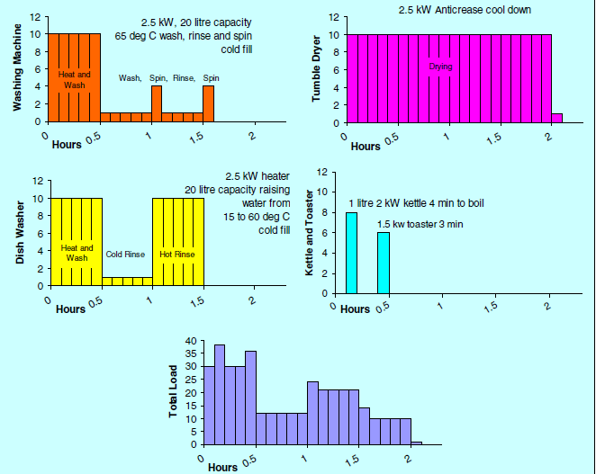

I have to agree with @JohnW2 I think if the gas cooker was invented today it would be banned, I look at the safety features of my induction hob, and think how can anyone consider gas?
But during WW2 when the ring final was invented it was well ahead of it's time. There was no 1/3 rule on drilling beams, and no insulators on the live pins so the 13 amp plug could supply 13 amp and the fuse cool enough for as long as one liked, there was no reduction in heat removal due to insulators on the live pins, and 7/.029 was nearly 3 mm so even it the ring was broken there was really no problem.
The problem arrived when insulators were put on live pins and the cable size reduced to 2.5 mm² and the protective device changed from 30 amp to 32 amp, the combination resulted in the potential for an overload of an extended duration. The limit of 2 KW for fixed appliances in the main removed the problem.
So the washing machine, tumble drier, immersion heater, oven and other fixed high power users were removed from the ring final load. However it seems people do not read the appendix to BS 7671 and the washing machine, and tumble drier are still connected to the ring final, if we had radial we could not do that, it would trip.
As to if having a radial that forces one to follow the appendix guidance is good or bad is up for debate.

First there is no limit of 2kW limit for fixed appliances in the regs. It is guidance but not regs.
Second washing machines and tumble dryers do not trip on radials. I know several people in Europe with such setups and no problems.

I don't get that. Whether or not 'it trips' depends upon how many, and which, high-powered appliances one has running simultaneously on the same circuit, and the rating of the OPD of that circuit. If one ran multiple high loads on a 32A radial, it would be no, or more, less likely to trip than if they were on a 32A ring, would it?
In reality, I actually doubt that a WM and dryer on the same 20A radial would often, if ever, trip the OPD....
