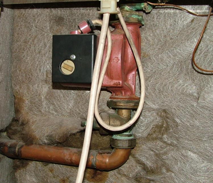

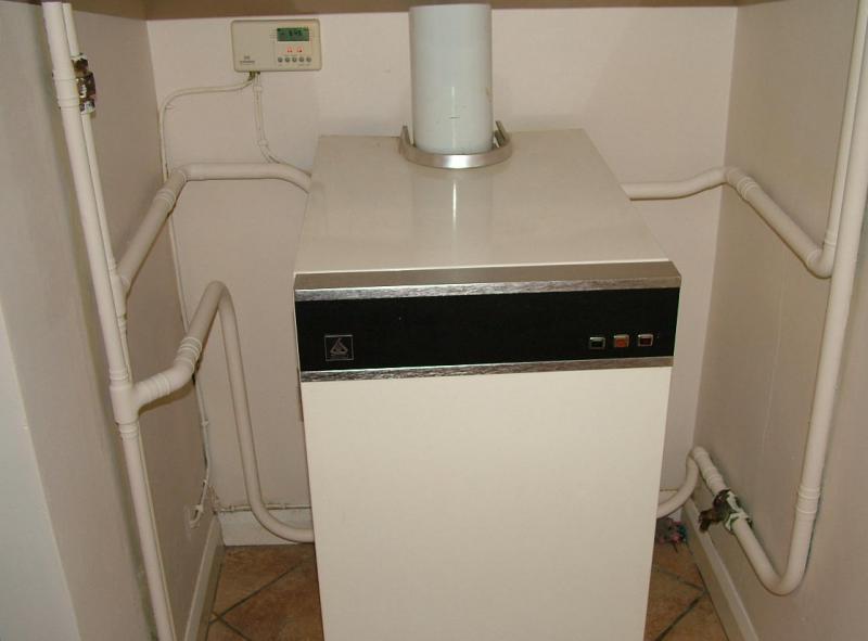

I have an old oil-fired Trianco boiler. Separate circuits for CH and HW , no diverter valves anywhere.
Boiler downstairs in kitchen. Hot water tank upstairs in airing cupboard.
Towel radiator in bathroom is part of the hot water heating circuit.
Since last year , radiator on landing now gets warm when the hot water is on but CH is off, likewise other upstairs radiators , though not as warm.
I guess I should check to see if CH pipes out of boiler are warm when the HW is on, so it's down to convection?
Otherwise I can't explain it.
Can anyone out there ?
thanks

yes , just above the pump is a manual valve , like a tap. I assume it's there to isolate the pump if it needs replaced.
Checking this evening - both sets of pipes are hot , though the CH is not on. The hot water is.
The pump only has valve at the bottom to isolate the pump.
I have the original Trianco TR90 product manual but it doesn't show the heat exchanger in detail and the back of the boiler is very inaccessible.
