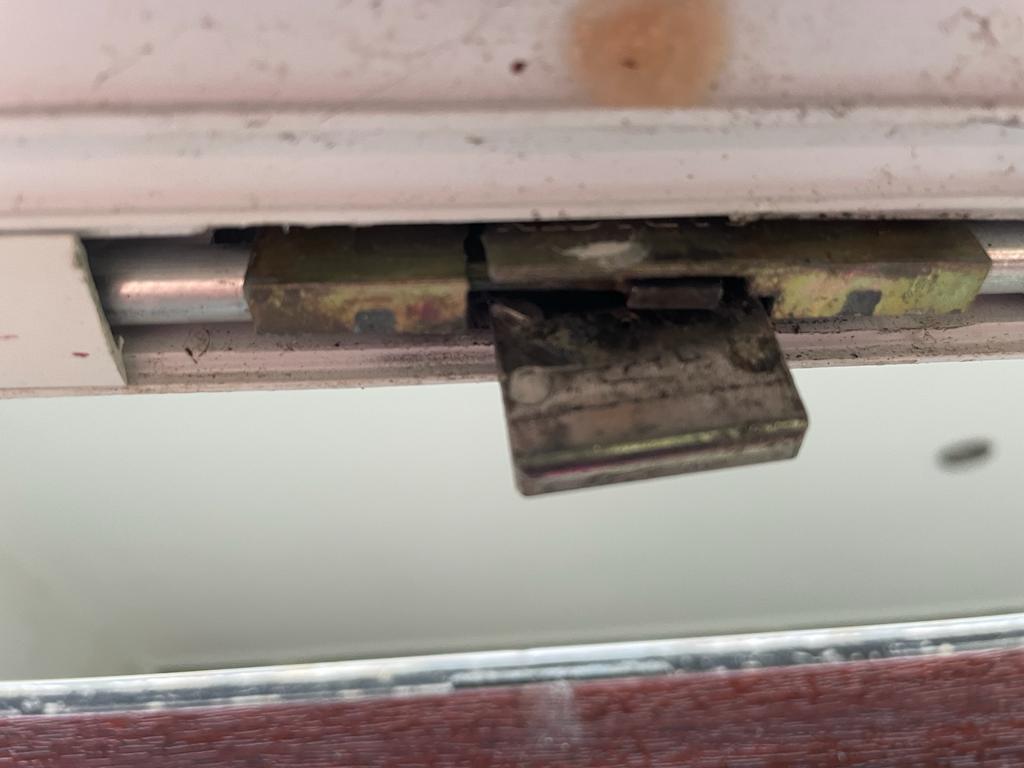

Seized window:
The not seized window open including the shootbolt:
First thing I need to do is try and get it open so I can utterly bin this hateful mechanism. Does anyone have any tips to getting this window open? I've tried prying it and it just appears to be damaging the UPVC.

I don't think that the allen key trick will work here because the bolt protrudes out of the side of the window rather than up and down like in those. If it did so, I'd be able to open this thing significantly easier :(

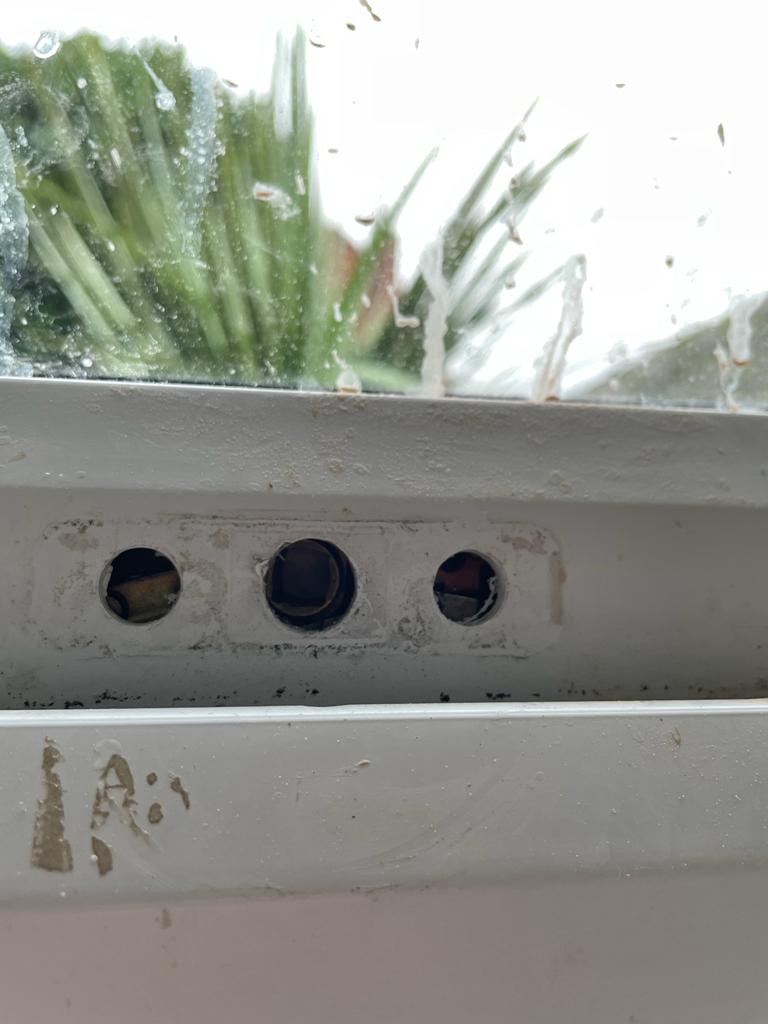

I've got another photo. Is there anything in that right hole I can adjust?

Try grabbing onto anything you can through the hole, with some needle nosed pliers or similar.... and try jiggling!
There's no guarantee it will help, but I think the next step will have to be deglazing.
It's usually not too difficult :confused:
Unlikely that doing anything in the ' hole' will open it ..especially if the problem is what I think it is but its certainly worth a go lol. It is beaded on the outside and looks like it's security tape ( glorified double sided foam tape ), which means you'll need to wedge the glass out with a scraper and there is a real potential for it to break BUT sometimes they can come out easily as some adhesives on some tapes weren't very good! Remove the beading and give the glass a gentle lever, if it moves then the job is easier and remove the pane of glass and then continue as per my description earlier. Being a conservatory 8t might be toughened glass ( will have a mark etched in one of the corners) , now toughened will actually bend a bit, so should come off the foam tape with gentle force...use something between the pvc and the foam , ideally plastic or wooden for greater protection of the glass. ( work on bottom edge and ideally have some one stopping it from falling out on the floor!). If toughened it may bend enough to wedge the free corner out past the frame eithout deglazing it BUT it does carry the obvious risk, without being there to test movement and amount if pressure I couldn't guarantee that the unit wouldn't break. If you are in any doubt I really suggest getting a Double Glazing repair person to look at it, as then all the risk is theirs
So I had a go at the 'hole', as it were with a flathead screwdriver. After wiggling various bits, mainly in the right hand hole, various pushing and nudging, something slipped and it appears the shootbolt returned ever so slightly, which was just enough to get the window open with a bit of brute force! :D Thanks for the advice on this. I tapped both shootbolts back in with the handle of the screwdriver, so the window should be fine until I install a new lock, although without a handle I can't easily close it!! No big deal though.

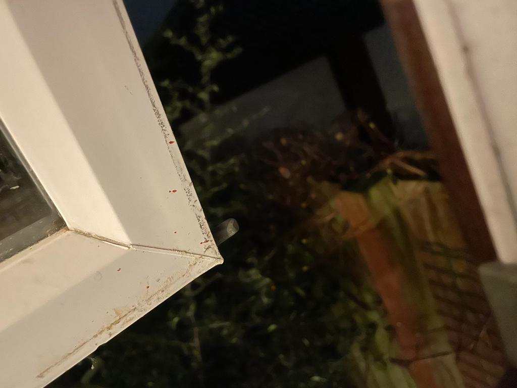

The right hand shootbolt before tapping.

So I've just taken a closer look from the outside and like sherlock holmes (or more like scooby bloody do), detective Skezz has this groovy mystery solved... the centre lock is completely sheered in half. No wonder the shootbolt wasn't firing. I suspect I just finished it off with the screwdriver.
It doesn't look as though the shootbolt has suffered any damage whatsoever, so I'm somewhat working out my options are :

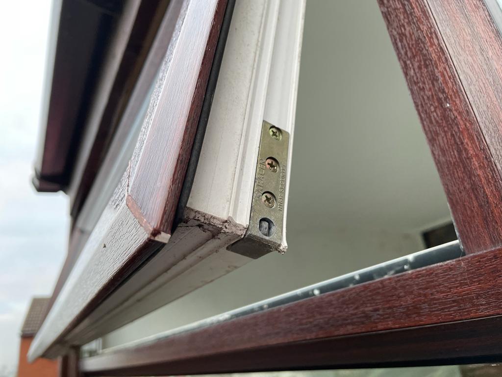

1. Install an Espag, I would need a kit and to install the keeps here, drill and screw in the keeps here I'm guessing?:

You will need to remove that existing lock anyway , as thats either a pushfit shootbolt , or a screw in .. saracen made two types BUT the gearbox should be readily available if memory serves me correct
Hi Ronnie, it's a push fit. Twist and push.
I measured it, 20cm backset and 11.5m latch, so I've ordered one per those specs. I'll try it with the shootbolts installed and without. I assume the shootbolts fail due to the added mechanism friction. If I think it's too much, I'll just leave the shootbolts off :)

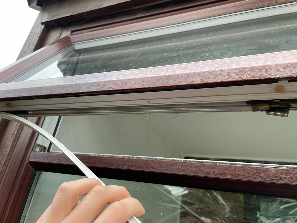

So, I'm back.
I thought I had ordered the wrong mech as I couldn't get it to line up, but I think I was just installing it wrong with the shootbolts connected. I couldn't get it to line up with the frame for the screws. I went and had another go and one of the shootbolts dropped out of the frame, so I removed the other. Mech went in fine and looks great with a new handle. To be fair, I don't think the shootbolts add a whole lot other than security and perhaps a tiny amount of draft reduction. There's a tiny gap between the seal in the left corner that's not present on the right, but I can't imagine it's that much better with the shootbolts. I could have a look I suppose. I'll measure over the next few weeks if the room remains as cold as it has been due to the window being partially open.
However, two things I did notice:
The shootbolts aren't set to the same length. One is slightly shorter than the other, so perhaps a bad measurement when these were installed.
The new mech latch bolt is definitely 'interfering' a bit with the keep in the window + frame itself, which you can visibly see the window 'pull-in' flush with the frame, although the video i've taken is not brilliant. Something feels as though it's flex'ing ever so slightly. Is this normal as this is something I've noticed the same on the other frame as well and I put down to the shootbolts but I'm not so sure now. It doesn't feel hard to open and close as such, but I can imagine it increases the wear factor on the gearbox.
