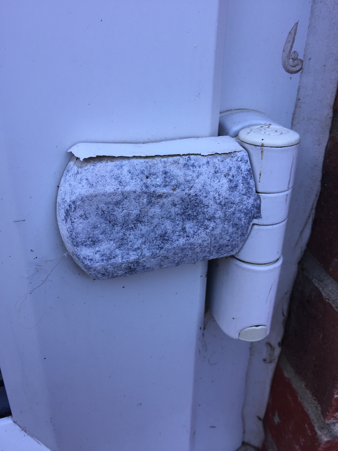

I have been searching to no avail with this one - the cover / facing on the arm of an external UPVC patio door hinge appears to have been weathered away to virtually nothing leaving what appears to be a composite inner. It doesn't seem to be getting worse but is unsightly, and the other hinge covers may be going the same way. Does anyone know of repair options? Thanks.
It's a 'Trojan patriot 3D flag hinge'
What's happened is the powder coating has failed and now the bare aluminium underneath is oxidizing, you could pop the front covers off I think and sand them down, primer and paint them or get them re powder coated, but then it might be cheaper to just replace the complete hinge, doubt very much that you could just buy the front covers
Thanks for the info, appreciated. I think attempting a cosmetic fix might be in order as a first option
Good point. Excuse the ignorance but I take it replacing the bottom hinge entirely wouldn't require the door to actually be removed (it would instead still hang on the two hinges still in place above while doing the job)?
