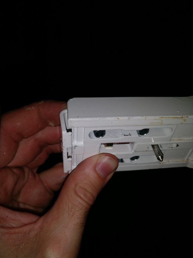

Hi folks,
found this forum having spent the better part of the weekend trying to figure out how to remove a door, without much success!
I have an external UPVC door between my kitchen and Conservatory, that I am replacing with another, fully glass (for light) UPVC door.
I don't appear to have enough headroom to lift the door off the hinges (door hits on the return sill at the top before it can come off hinge) so I'm assuming my only option is to remove the door from the hinges entirely, which means getting behind the cover plate.
Problem is, I cant figure out how to get the cover off to get at the screws!
There's no screw on the back and no obvious clip which releases it. I've used the allen key to move the door as far along the hinge as possible, which exposes a hole on the back, but pushing in there with a screwdriver doesn't obviously release anything (even if I hit it with a hammer)
IMG_20170605_131136.jpg IMG_20170605_131139.jpg IMG_20170605_131146.jpg .
Anyone have any idea how to get this door off?
Attached some images of the hinge. Any help gratefully received!

Sorry I scrolled down to your photos and missed the text above, will the cover knock over to the left? Can you get something thin behind it - where the Allen key hole,is, it might pop off and swing around?

No. but it does look like it's hinged that way, that it is somehow meant to swing open from the front right, away from the door. It just looks like it needs some sort of "release" and I cant find it. I've tried the hole on the back and the hole on the front to see if theres anything obvious, but nothing that is releasing any of the 3 hinges. I'm hoping theres a "trick" to it or something. :)

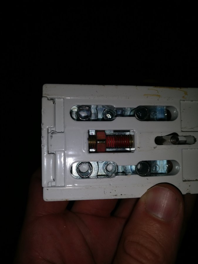

Below are pictures of the hinge cover, which seems to have a couple of little hooks on the back that holds the plate in place, no screw or grub or anything to flip it off. If anyone has any ideas how to get this front cover off the door I'm keeping without damaging the door, feel free to let me know, I cant for the life of me figure out how these things were ever supposed to come off again! :)
So they wrap around the hinge pin side and the right hand side must just thump on, once it's on its on and the adjustment is though the hole
Aye, that's what I'm worried about. Might need to cut them all off and buy some new hinges. I'm only about 7 or 8 mil from being able to lift them on. Other option I guess is to cut a bit off the top of the hinge pins?

OK - so for completion in case anyone else ends up looking for a similar solution. I was able to get the cover off by placing a phillips screwdriver into the adjustment access hole and prying the driver so that it just flexed the 'clip' part of the cover off the lugs to release the cover. All four came off without difficulty.
