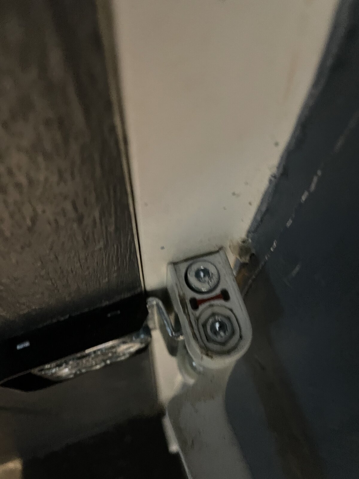

Can anyone give me an idiots guide on how to adjust these hinges. Door is not level in the frame and is rubbing on the bottom handle side.
Many thanks
Rob

Look at the 2 allen headed screws in the centre, the left one will have an arrow on it pointing left and right, lock and unlock, loosen that by half a turn then turn the other one left or right and watch the door move sideways, once in desired position then lock the first screw back off. You can manipulate the door up by adjusting the top hinge to the right and the bottom one over to the left, this will cock the door over but all depends on the gaps down each side as these will change too.
If you need just straight forward up and down adjustment then adjust the back allen bolt on the frame portion of the hinge, screwing it down pushes the hinge and door up

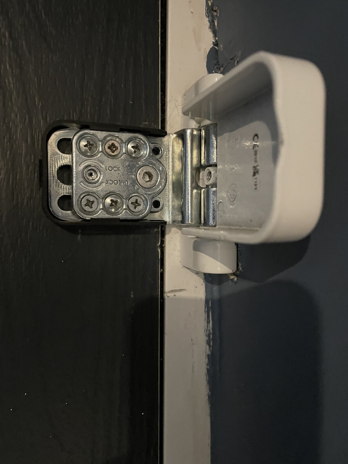

Thanks but what do these do ?
As explained in my post above the back screw lifts the door up and the front one alters the compression, it's in the video too, did you watch the video?
