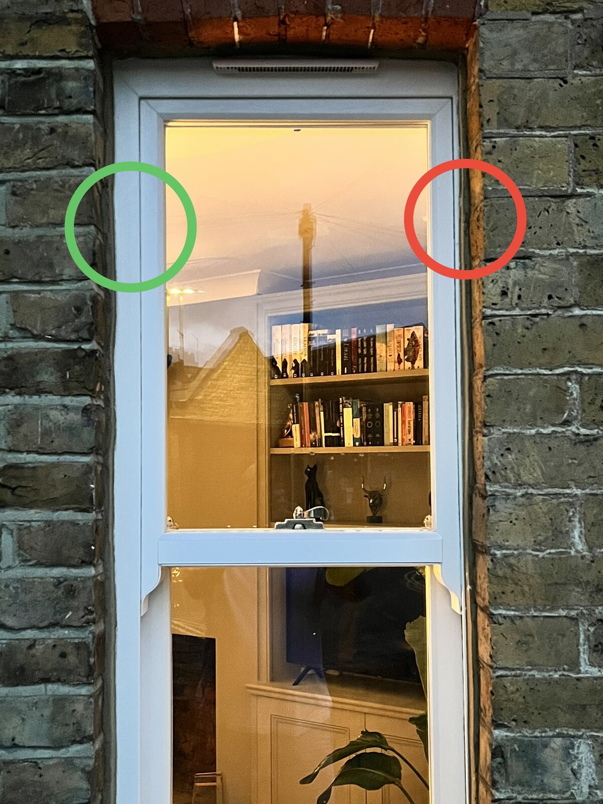

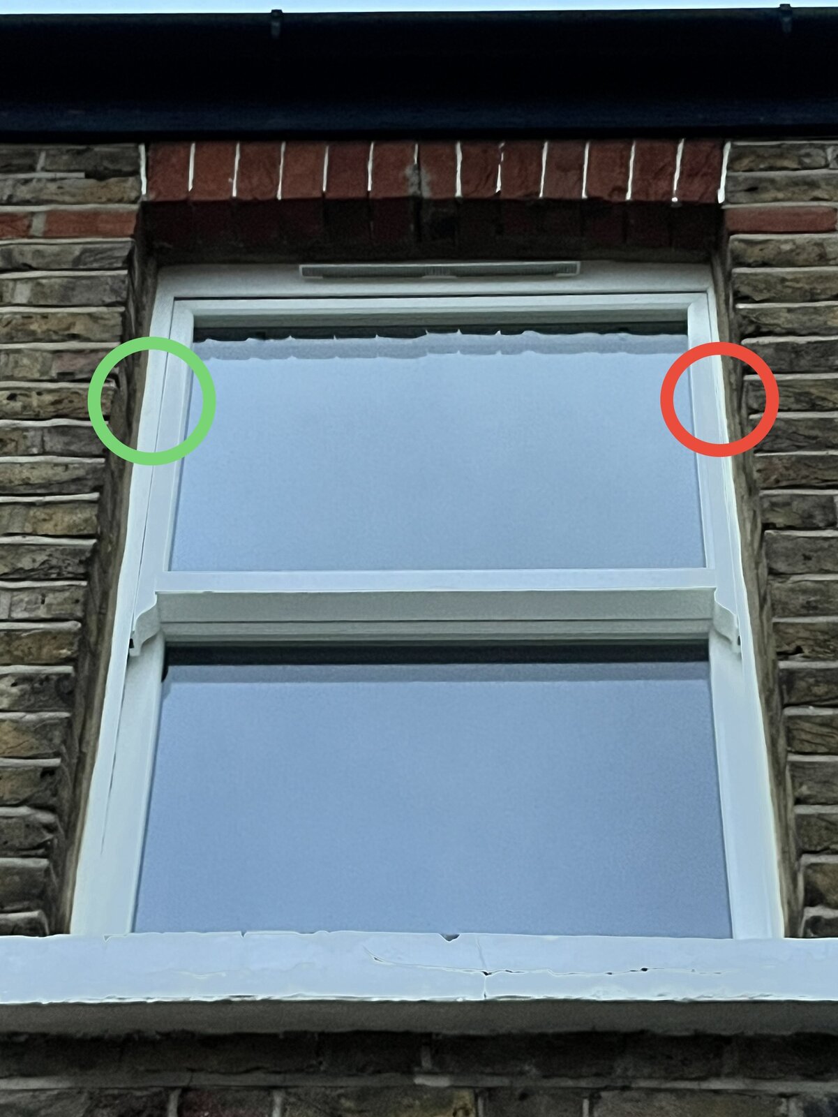

To begin with, we noticed that even though the interior positioning and appearance of the windows is ok, from the outside some windows do not look centered, ie the frames around some of the windows are thicker on the left vs the right. Please see some pictures to illustrate below. One is from the lateral bay window and the other one from one of the first floor windows. The company said that this was necessary to align it inside and also given the curvature of the walls (which are not curved!).

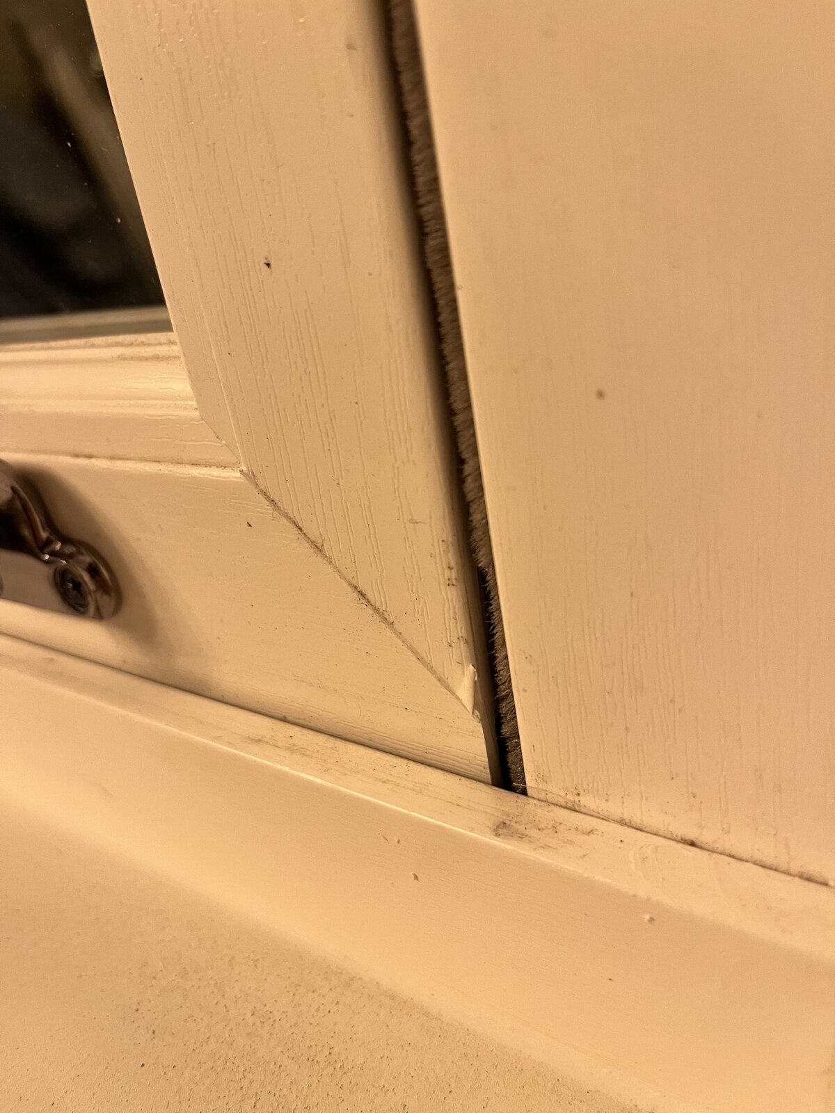

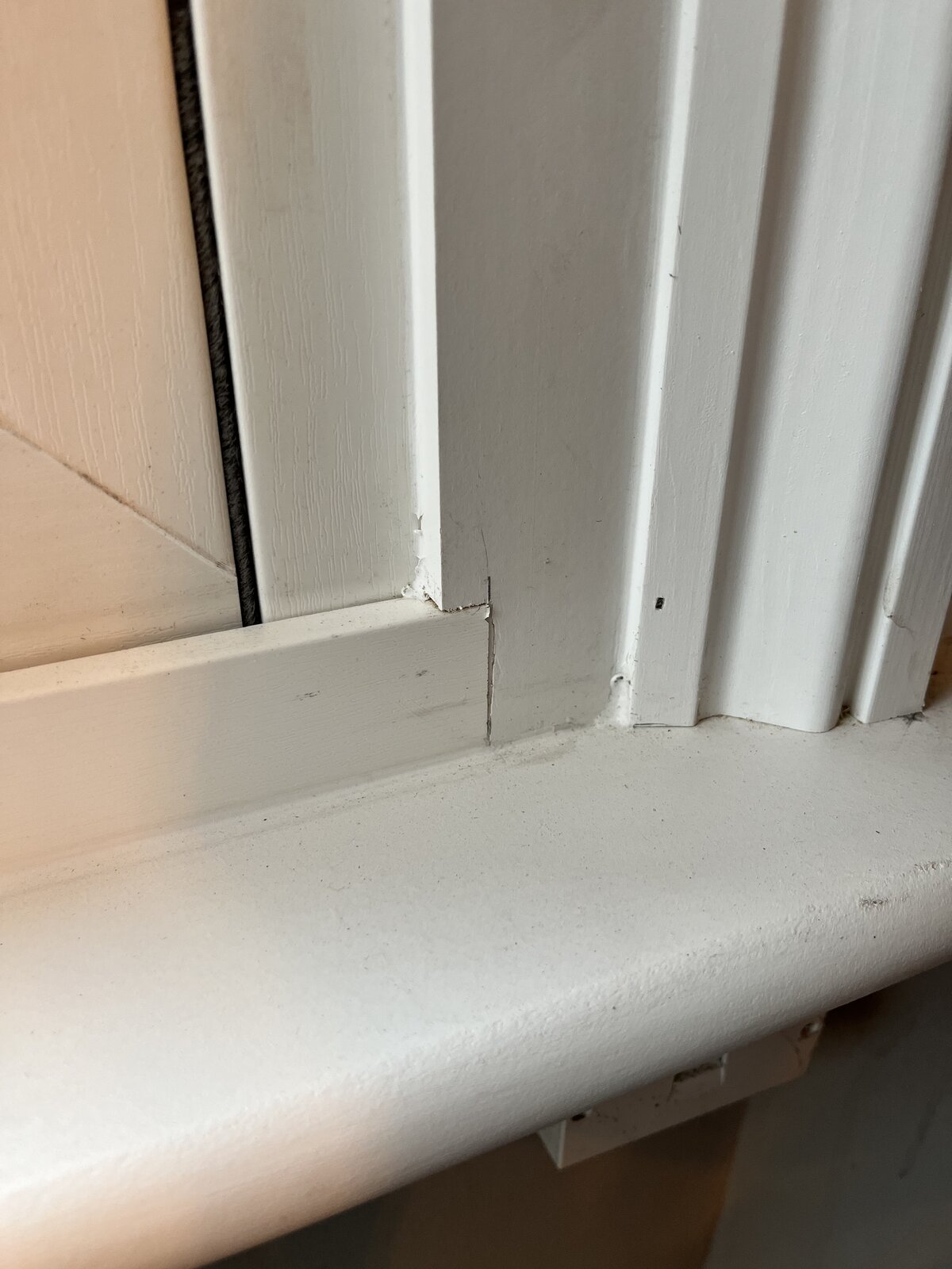

Secondly, the welding of the windows is not always straight on some corners ie the line doesn’t end exactly in the corner of the window. Please see some pictures to show this.

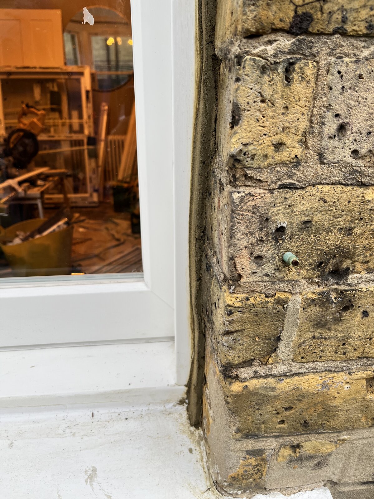

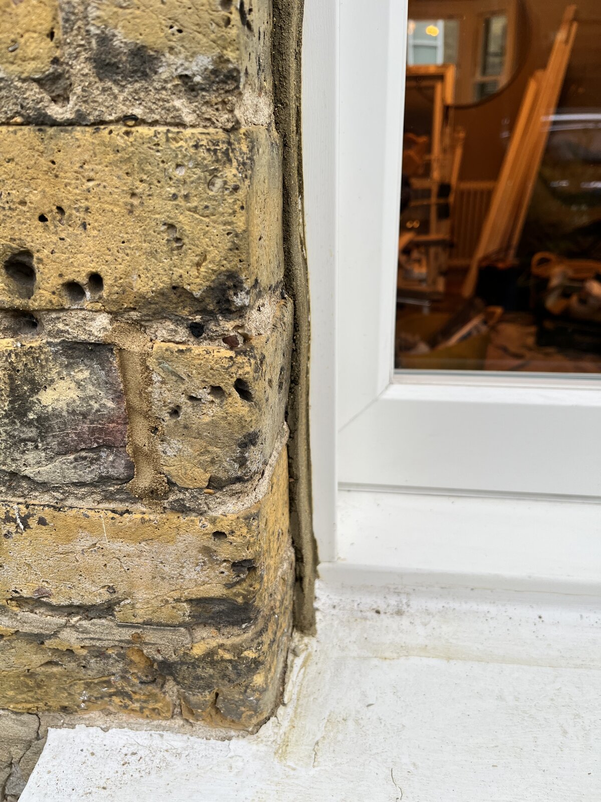

Also, it looks like the pointing is uneven and very thick. The company says that it is their standard and they are following the shape of the bricks, but it looks very ugly and not neat at all.

For my money, I would not like to have or pay for that.
I've fitted my own sash windows and it's imperative that it looks centred in the brick reveal.
If this frame is thicker on one side, it's probably a 'knock on' that's been added to one side, due to brick work.
That said it should be doctored to fit and look correctly fitted, or has been incorrectly measured.
Were there vertical bits of wood at the reveal sides when the old windows removed?
The mortar work, difficult to comment, it's wavy but looks neat(ish)
The mitre-ing on the bottom rail won't be 45º corner to corner as the sides of the sash are thinner than the bottom rail of the window. Only way around this would to have mechanical joints and not welds, this does add to the cost though.
