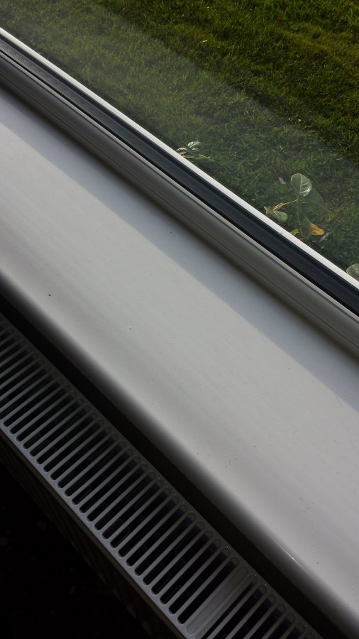

Another question I have is regarding the sills. These are all uPVC and do not seem very smooth - they have like ridges on them that you can feel almost what's underneath. Is this normal for plastic sills? I assumed they would be quite rigid but do not appear to be at all.
Thanks for your help!
Ridges running along the length are extrusion marks but these are very faint, sometimes you can feel and see bigger ridges, more like bumps, these are usually the PVC sagging between the chambers, again if not stupidly obvious then nothing to worry about but a picture would help, if you can it to show up?
Here is picture of sill. There seems to be a dip before the bullnose edge and then you can quite clearly see thearks. Not sure if I'm being too fussy?!!!
Ah internal sill, we call them window boards, still hard to see on that picture but in any case its probably a dip in the moulding and if it really bothers you then it can be replaced but will be glued down if its capping your old board, probably an hours work with all the making good afterwards
