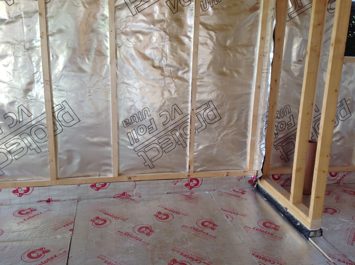

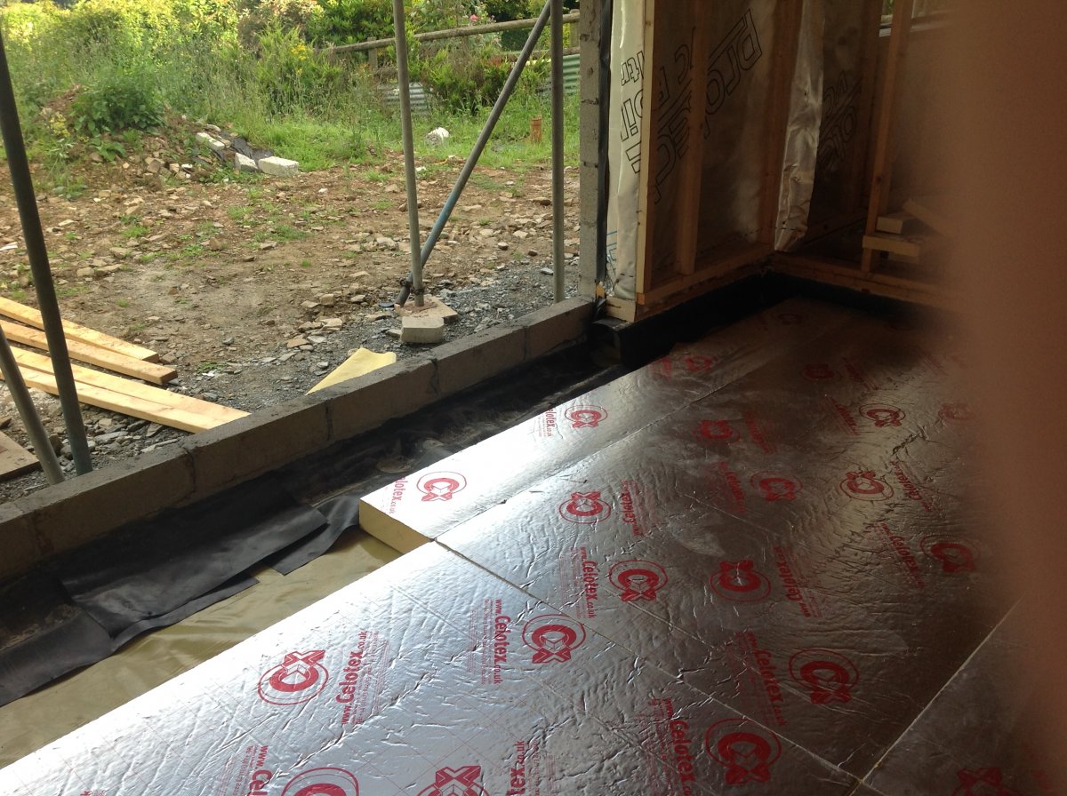

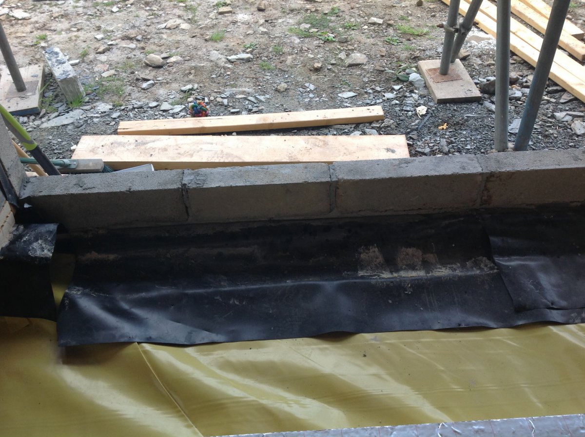

hi guys thanks for looking in i have a problem and unsure how to deal with it im sure one of you clever people will.
Laying radon barrier and insulation in a new timber frame build, needs to be completed tomorrow ready for plumbers on monday.
All going great until i come to the door,openings around rest of house we have dolly block covered in a dpc so we just lapped radon barrier under and taped up joints, on openings though we have removed dolly block as we are having a polished concrete floor installed and needed the depth of concrete at thresholds, so my problem is what to do at these openings, i want to carry on an upstand of insulation across thresholds while mainaining the cavity but unsure how to, do i lay a new dpc over block where doors will go and lap it inside to meet barrier?
Ill post pics in the morning its hard to explain
