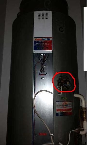

The 11" thermostat rod I replaced was located in the highlighted area below (not my actual picture, just one i found from google) :
Sorry for the very poor questions, but when you say there are two heaters, each with their own thermostat/sensor, could you please let me know where I should be looking? I was under the uneducated impression that the pulsacoil 3 has a thermostat sensor (the white wire sensor) and the 11" thermostat rod located under the black cover with the temperature dial, which were the main 2 things which could fail or need replacing in the event of the water overheating. I take it I'm wrong on that? :oops:

The other heater is at the bottom of the cylinder, directly in line with the one circled in the picture.
Top one is only used for boost / daytime. The lower one is used for most of the heating including overnight.
The hot water sensor is only used to monitor the temperature of water going to your taps, it is unrelated to the temperature of the store.
That would make a lot of sense. Thanks very much for explaining that.
I will order a new thermostat rod for the bottom heater and give that a whirl. In the meantime, as my timer is set to heat the water at night time, and I very rarely use the boost, is it possible to swap the new rod (from the top heater) with the old rod from the bottom heater? Could that work? Obviously that would just be a temporary measure whilst the new part is on the way. Or am I getting a bit carried away with myself there?
