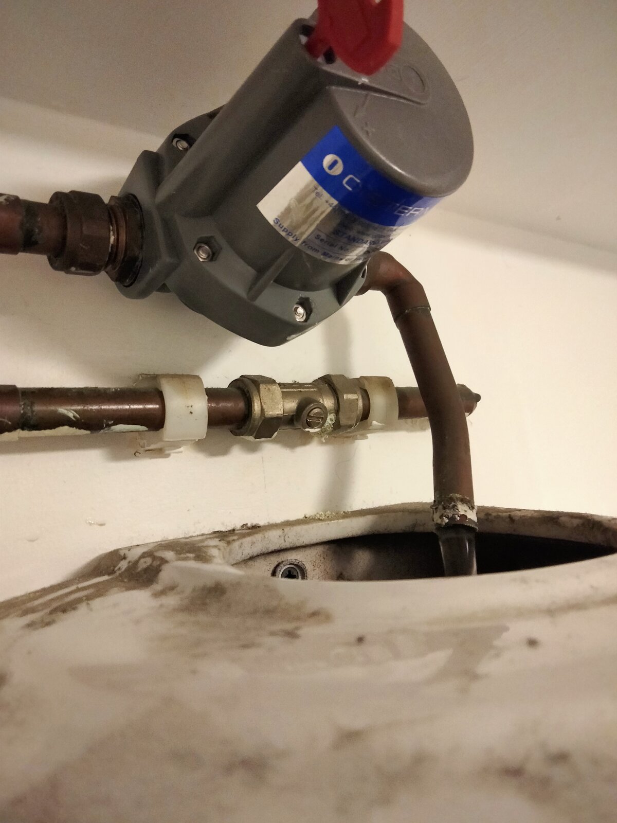

How much water should this let out each time a tap is opened? I turned it down as was filling the cistern fully after the basin tap was opened once.
Flush within 20 minutes of a urinal being used and every 12 hours when they have not been used.
Andy
Well I never hung around very long but I recall a short burst no more than say 5 seconds when washing hands . they can be affected by water drawn in other parts of the system . yours seems to be knackered
Have have turned it down so it now just giver a short burst after a tap has ran.
