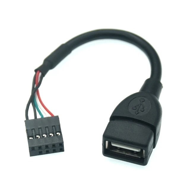

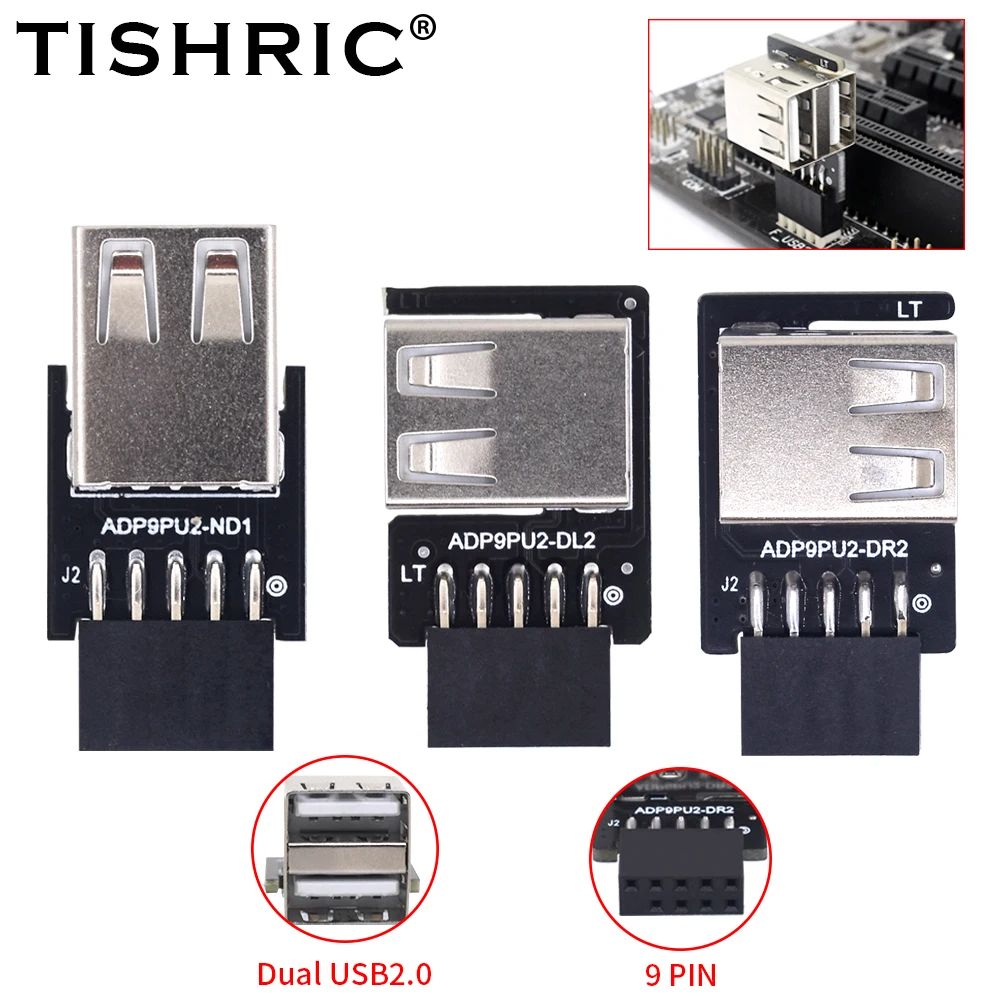

Given the external antenna, for neatness, I may have considered keeping the module within the case, running the antenna outside and if I had a spare USB header on the motherboard, possibly used one of these, to power it...
That might be a shout, although its some chinese cheap stuff with god knows what the device might transmitting, I am tied to the Tuya/Smart life ecosystem and works very well with Alex and such. So maybe if i'm feeling brave could flash it. I have a second one I bought for my main gaming PC might try it. It cost like £14 from AE.
But that USB 2 to UBC A thing - its on its way - but intended to use for the OS USB drive - but might use it to power this! This is the one I got.
