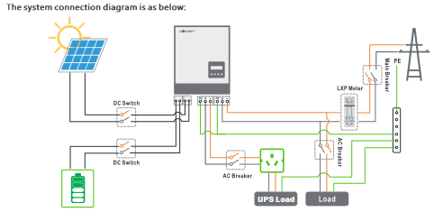

Sorry my freezers and boiler are on an UPS which is part of the solar system so even with no grid power, my freezers and heating will continue to work. So the supply is from the inverter, there are three new isolators two for DC and one for AC and I thought turning off the AC isolator would allow me to work on the UPS supply, but no, using my non contact volts detector at least I could see still live.
It seems to make dead both the button needs pressing and the isolator turned, if either not done it stay live, I know whole idea is for it to be uninterruptible, but I would have expected to see detailed instructions on the unit, not having to phone the electrician who installed it to find out how to isolate it.

there are three new isolators two for DC and one for AC and I thought turning off the AC isolator would allow me to work on the UPS supply, but no, using my non contact volts detector at least I could see still live. ... It seems to make dead both the button needs pressing and the isolator turned, if either not done it stay live, I
That sounds positively dangerous, don't you agree?

Yes I do, in fact if I was doing an EICR think I would give it a code C2. One should be able to lock off an isolator, and clearly no way to lock off a push button, I worked as if it was live to be on the safe side.

Can't see how that is satisfied. There are a whole load of British standards for isolation can't see how it can apply to a push button. I would have expected at least a notice 1697139392910.pngand looking at the manual for the inverter it shows
which shows an "AC Breaker" on the UPS supply. And a DC Switch on the battery supply neither seem to have been fitted, however I am guessing I have the right inverter as to date all I have is a compliance certificate which was issued before the work was completed.
