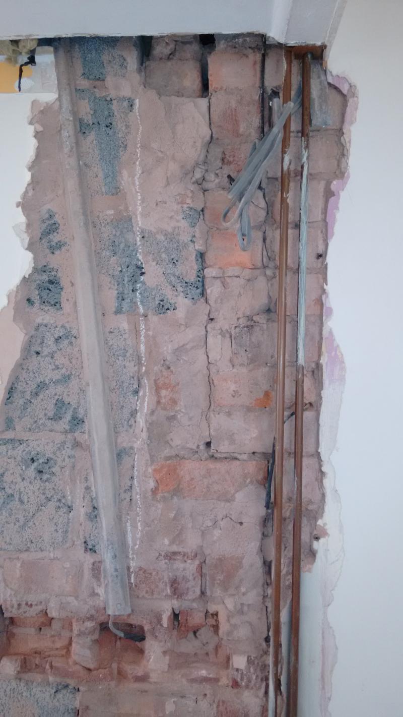

The wall is breeze block which has been cut into another brick wall quite roughly (see pic below)
I only want to remove part of the wall and figured a cut off saw would cut through where the brick and breeze block meet. Then I could just plaster over the remaining section without having to build it back up again.
I suppose I could do it with a hammer and chisel though.
If you are that worried about the petrol exhaust, use an electric one, cutting through brick inside is fun. Takes about 20 seconds and you can't see a foot in front of your face.
Last time I did something similar I just stitch drilled all the way from top to bottom and tidied it up with a cold chisel.
OP,
as you suggested, simply use a hammer and chisel. If you dont mind the dust even use an angle grinder (a 115mm grinder will work) with a masonry blade - you only need to nick the brick or block a few milli deep, and a sharp blow will split it along the cut.
Its a simple job, dont make it hard or complicated.

Thanks for the advice. A cut off saw does sound like overkill for this job, so I will do as you suggest.
