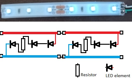

As far as I know, a LED lamp fitting is going to be a string of a few LEDS, and a resistor to limit the current, so a small voltage drop wouldn't be significant.
That is true for LED strips and tapes
but for other 12 Volt lamps there is invariably a driver to produce a controlled current through the LED element(s).
Some of these drivers will maintain the correct current irrespective of the supply voltage ( within limits )
