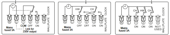

One channel only: Note that the output contacts are voltage-free*
* Not SELV - Fixed wiring only, to comply with current IET regulations.
Not surprised, but what IET regulation? Quotes from Drayton Wiser installation instructions. I have said that the three options are
asking for problems, where the wrong thermostat is used on the backplate, which is so easy to do. The "Link for 230V output" seems to suggest one can use another output voltage, and we have FELV and PELV as well as SELV, so why pick out just SELV?
